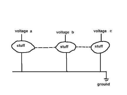

here it is in a nutshell
electrons flow between voltage and ground
through stuff
and between stuff
think of ground as a big reservoir of electrons
they flow into it from a negative voltage
and out of it to a positive voltage
(current is electron flow, but by convention is opposite in direction)
voltage (potential difference)
it the "pressure" that
drives the electrons in one direction
or another
here's a diagram

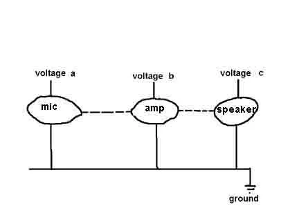

give it some familiar names
ground can be an actual copper pipe
driven into the ground
(or attached to your house's water pipes)
or just a common connection between several circuits
for instance, if they're all battery powered
and never "plug in" to the mains
