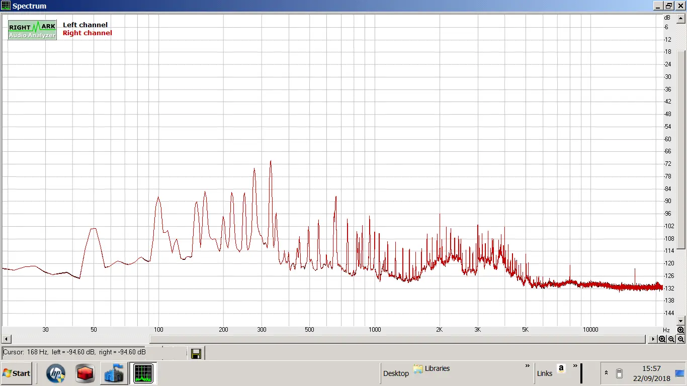

Some numbers.
I was going to check the Mex Strat I recently screened so this has shifted my arse..
The barr A was played through an HT-20 head+Greenback. The level at my chair was thereabouts 90dBC on a cheap meter.
Mic was a Prodipe TT1 (about the size of an SM58 and about 1/2dB more sensitive) and was about 2" from the speaker fret.
AI, NI KA6 with gain at 11 o'clock, the chord was hitting -25 to -15dBFS.
Turning guitar VC to zero gave just the amplifier noise at -74dBFS
The spectrum shows the amp noise only. The 50Hz peak is I am sure power traff induced into OPT. The stock 20 is about 10dB worse than this so I modded mine. Never had anybody else be as fussy tho! Tge 100Hz peak is almost certainly OP valves not bang on balance. Not that I could hear either him in the room. Wind up guitar and it gets worse of course.
So, there you have it. With THIS amp and THIS guitar I can get a S/N of about 55dB and with a bit of gain tweaking and getting guitar further from amp and PC, easily another 5dB.
60dB is about the S/N of a good (but not best) old tape machine so "they" did not have too much to do because it would not have been heard.
Last thought. When my Behringer BCA2000 worked it had a remarkably good noise gate in it. I bet there are some STONKING software ones now?
BTW. if that "A" sounds a bit odd? No top E! It pinged off whilst tuning.

Since I'm lacking recording chops I'll have to spend some time studying your post ecc83, but thought I'd mention my #1 amp is an HT40 loaded with an early EVM12L (I tried a Greenback before, and that speaker also sounded terrific in the ht40.) I've owned probably 30 or more amps over the years, and still own (among others) a Triamp MK2 and a DR103, but I only play the HT40.
BTW, you say you modded the 20. Can you say what you did to it?

The hum mod on the 20? Well, I COULD tell you but then.....! Ha! Easy, you just rotate the OPTraff but you need to make up a special bracket. As I say "I" could hear is and it pissed me off. Son, the guitar player wasn't bovvered!
