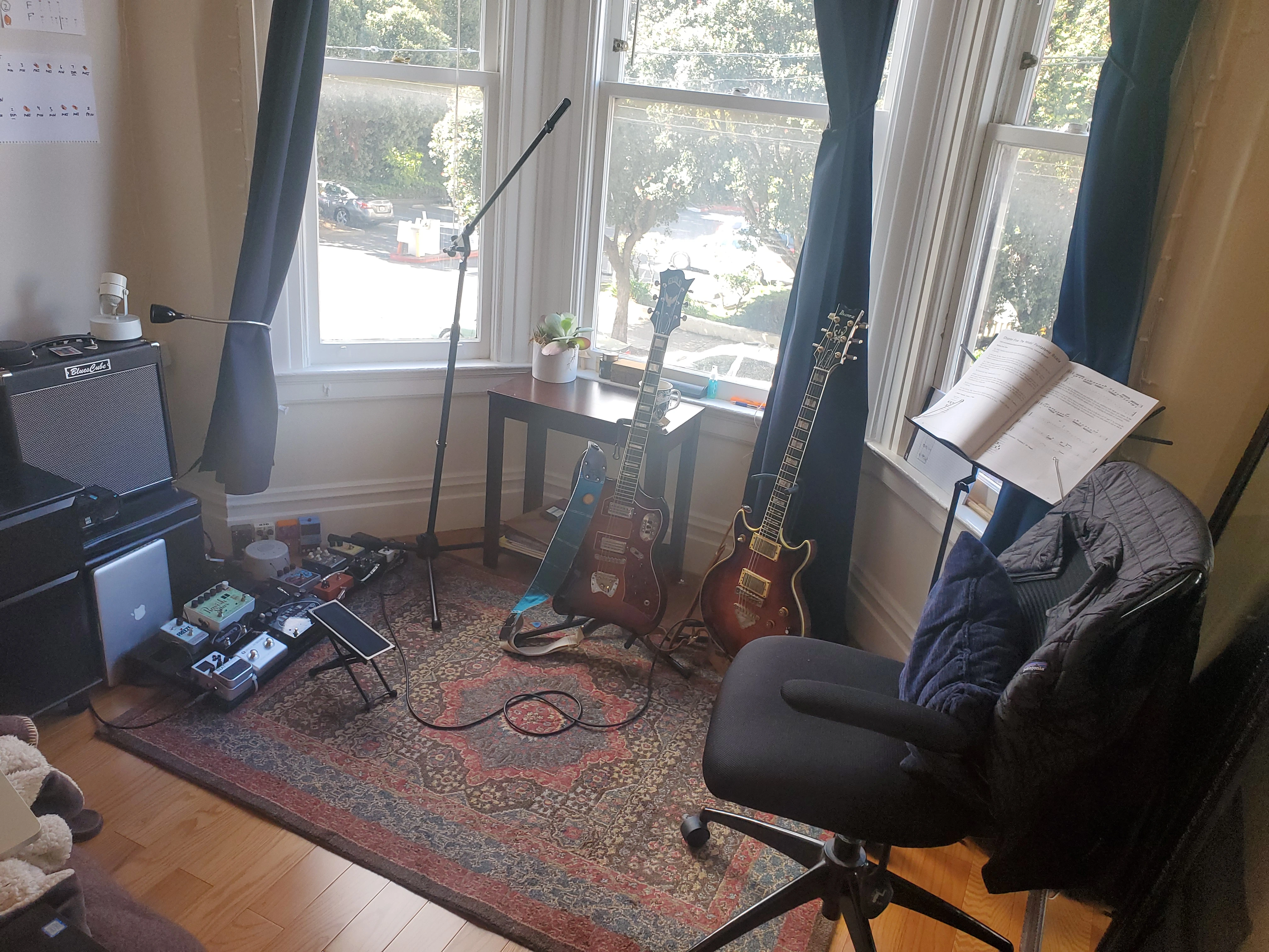

I am looking to record and edit songs in a small space in my apartment (7.5 ft x 9 ft) I don't know much about recording gear or software as this is new to me, and currently own neither. I'd to like to be able to come home and easily create songs without having to unplug and switch things around all the time. I'd like good enough quality recordings that I could eventually upload my songs to Spotify or similar platforms. Music is my main hobby so would like a good, functional setup that lasts. I use vocals, guitar, pedalboard, bass, keyboard. How would you do it?

One of the issues you are going to face in a room that small is the boxiness of the sound when recording with mic. The way to avoid this is to put a lot of absorption in place (bass traps, not acoustic foam). Unfortunately, you don't have much room to work with, so you may need to set up a 'dead corner' with some movable traps (gobos) behind you when you record a mic.
