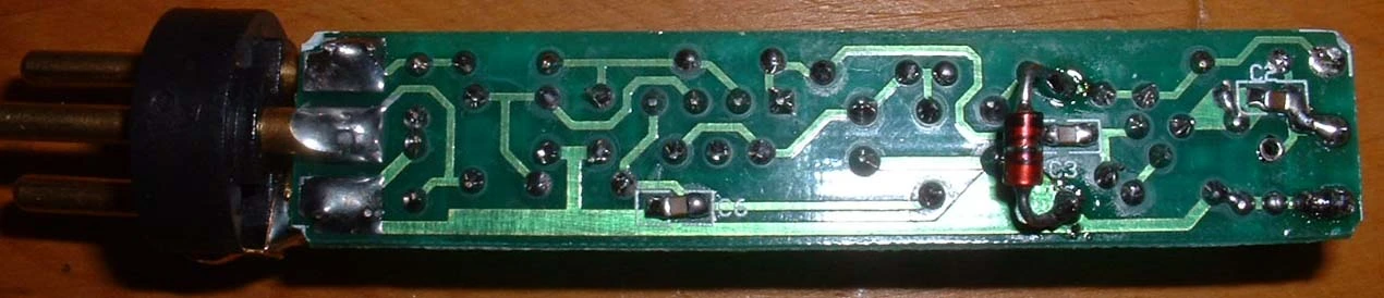

You know, there's not really much too that mic... it looks like the hardest part to making one is the PCB and housing. Does it have Behringer, 797 Audio, nothing, or what printed on the other side of the PCB?

Have a look. Sorry, I took a picture after I started working on that. I had only 1W Zener, so I put it on the other side--it was not there originally.

Well, the PCB will be easier for someone to copy now that we can see both sides... thanks. I wonder who made the PCB. What's the added diode for... regulating?
<What's the added diode for... regulating?>
Precisely! The original was at 6V, I need more, so this zener sets the voltage.

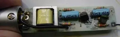

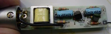

Here we are! What did I tell you? I knew I saw this thing with a transformer! Sometimes it is a good idea to hit a search bottom even in my own computer, he, he. Look what I found in my files--Behringer ECM8000 board--first revision! Now, all owners of ECM8000, open the thing and check it out. Picture of the other side of the board please.

Now that's interesting... so Behringer dropped the transformer is the newer ECM8000 without telling anyone. Maybe that's why Harvey's ECM8000's wern't as noisy as the one's I had... I sold mine because I thought they were too noisy.
Marik, please don't forget to post the ECM8000 schematics when you finish drawing them.
If anyone has an older Behringer ECM8000 with the transformer in it (Harvey?)... please post a picture of the back side of the PCB. Thanks
