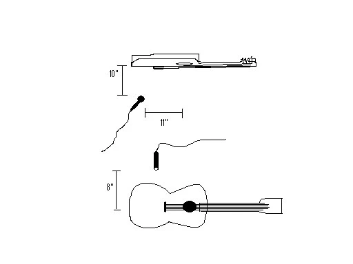

So the other day I did a little experiment. I set up one of my NT-5's and an old AT dynamic I had laying around (can't think of the model #, but it was nothing fancy) on my acoustic. The dynamic was placed about 10" out, even with the belly of the guitar and was aimed toward the sound hole. The condenser was placed in the classic over-the-shoulder way that I have used a lot in the past. I matched the levels, and recorded myself playing a part of Leyenda. I didn't EQ or edit them in any way, just normalized them. Guess what? The dynamic KICKED the NT5's but. Absolutely destroyed it. It was full and round without being boomy, and had a mellow tone to it. I'll admit that it was a little weak on the high end (no "sheen" to speak of), but it was very usable. The NT5 on the other hand (which I had previously loved) was harsh and screech-y and had waaay too much room sound, although I do have to admit that it had quite a bit more detail.
Now before anyone jumps on me, obviously the positioning had a big influence on the sound, as did the room (which might well be the worst sounding room in the world), but for this application, the dynamic blew the condenser away.
I had never considered puting a dynamic on acoustic guitar before, but I think I might pull 'er out more often in the future. In the past I had always just EQ'ed the NT5 to sound how I wanted, but the dynamic just made it sound so musical right off the bat. I love dynamics now!

It's really not a valid comparison in the least, because in this kind of situation, the mic positioning is going to have a far more drastic effect on what gets picked up than the mic selection. The over-the-shoulder mic is just going to sound a lot different than something aimed at the sound hole.

Let me see if I understand what you said accurately . you put the dynamic by the sound hole and the condensor is up by your ear over the shoulder and your saying the dynamic sounded better to you and the condensor had too much room?
DUH!!!
Why don't your try both mics on the guitar, maybe in an xy and see what you get.

Nope, I said: "The dynamic was placed about 10" out, even with the belly of the guitar and was aimed toward the sound hole." The mic was probably 15" or so away from the sound hole. Maybe I just explained it wrong...the condenser was actually a lot closer to the soundhole. Here's a picture (the dynamic is on top, condenser below):
Oh, and forgive my terrible drawing abilities.

ahhhh now I get it, so the NT mic is quite off axis from the sound source.
If your wanting to compare the mics to each other you really ought to use them in the same fashion. I know what your saying about the NT5 though, I always though it was pretty brittle and harsh sounding.
