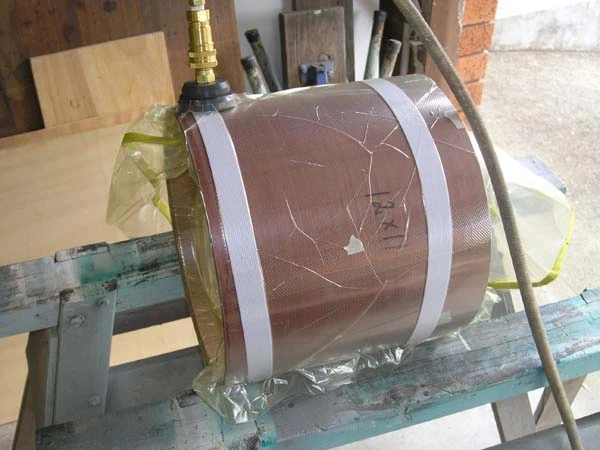

You can re-veneer shells but good/nice veneer is not particularly cheap. Doing the inside would really be a waste but if you had money to burn, I guess it could be done.
Veneer is usually 0.6mm thick and for this type of application is usually purchased "paper backed" which helps resist splitting as well as limiting the possibility of the glue bleeding through. The other thing I should mention, is that to do it correctly, veneering shells should be done with a vacuum bag setup.........pic is Rockstar tom shell I veneered a couple of years ago.
