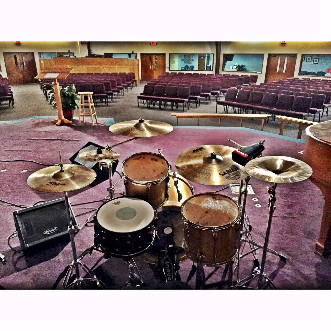

Yeah they are pretty big. Do you think i will have problems setting them up on a 4 piece?
It depends where your cymbals are. As long as you have enough space over the toms, you are find.
I always ran into the problem of guys coming in with 6 toms angled so the top was pointing at the drummers head and the cymbals 1/4 inch off the edge of the toms.
It's always different when you are only micing your own kit. You can decide to make your own compromises.
I dont think i should have a problem then. I will only be recording my drumset for now.
It looks like You will be able to sneak the mics in just fine.
