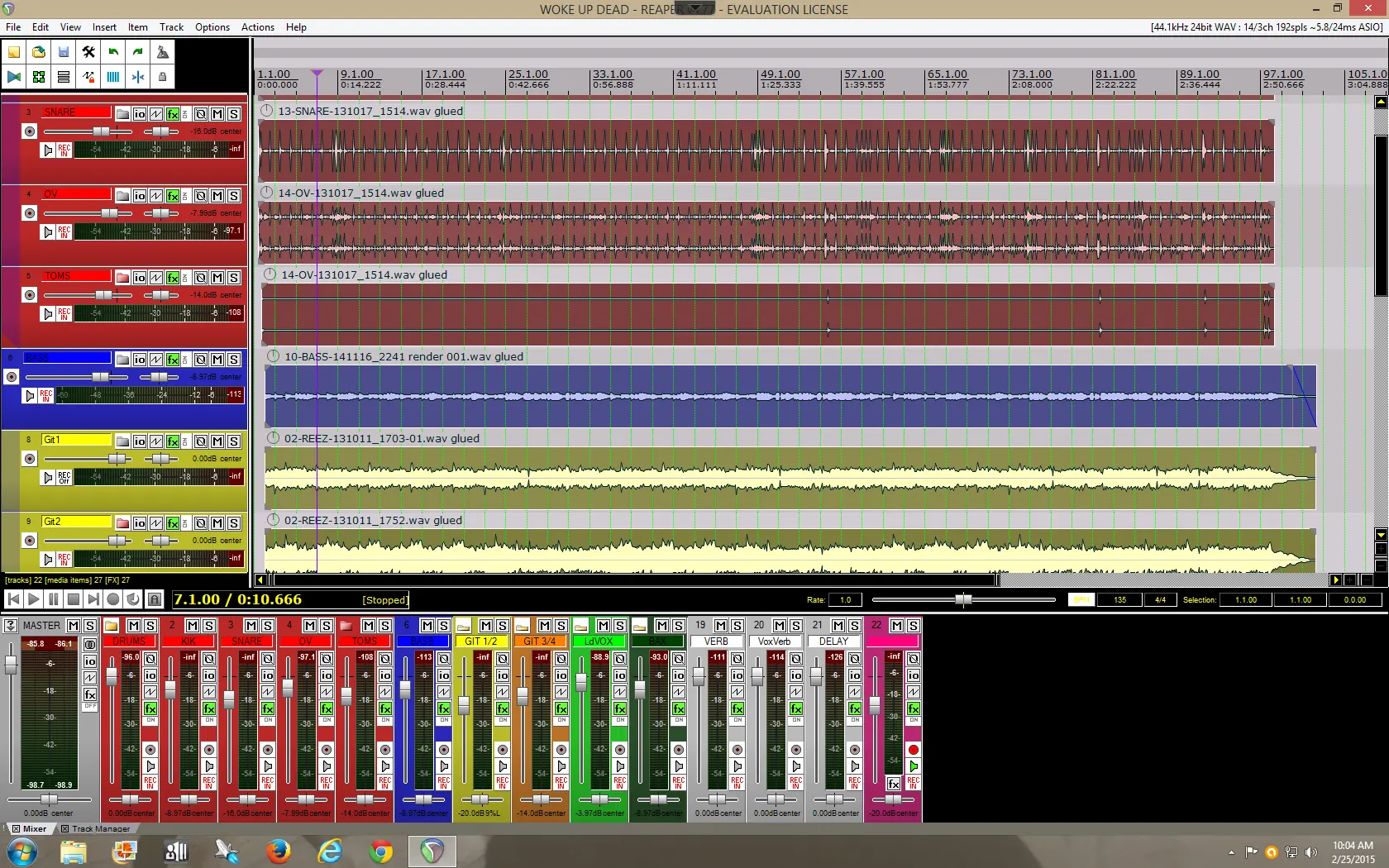

Does this matter? Waveforms................
  • Thread starter Thread starter RAMI
I love a happy ending. :) Sorry, the cave has worn off on me. lol
Actually, I'm not so sure any more, LOL. I just did it again and the wave forms looked the same. But I might have screwed up along the way. I'm too lazy to do the whole copying and pasting and opening new projects again right now. I'll try to confirm it again tomorrow. In the mean time, in case that wasn't the solution, if anyone else thinks they might know what it is, lay it on me.
Thanx.
Normally, when you see more quiggles, it means that there are more high frequency harmonics. But if it sounds the same, it's just a graphic issue, not a sound one.
Only thing I noticed was that the grid mark difference on the square wave was .003 seconds or thereabouts and on the squiggly wave was .006... but I've never seen a waveform go block as I've scrolled in, so it wouldn't be that...
Maybe there's some setting somewhere that affects the "granularity" of the waveform display at a project level.... it's clearly not just the OV / overheads, all the tracks have it... the two Git tracks look pretty blocky too, clearly something like a drum would be blockier than a guitar, but you can see it's there.

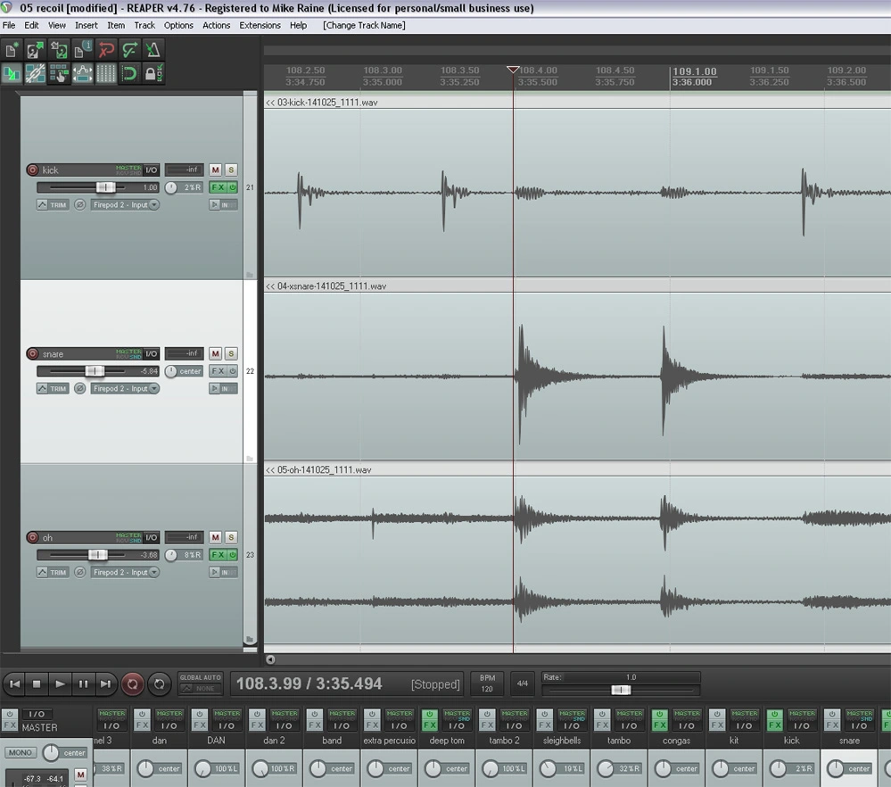

Just for interest, this what I work with. The fuzziness is bleed from bass and guitar

As far as the waveform is concerned, anybody's waveforms would get big and square like that if you maximised the view vertically and horizontally. I'm not worried about that. I'm concerned with one being "furrier" than the other.
I had thought the Clean figured it out, but then I wasn't sure. But now I'm beginning to think he WAS on the right track, it's got something to do with the options.
Check your settings here in the two projects... see if there's a diffierence mebbe?
Preferences Media Appearance - CockosWiki
That really helps a lot. I think it has something to do with this. Those different views and options are probably the key to the answer.
Right. That's how my waveforms usually look. But if I had kept them like that, you guys wouldn't have been able to see the difference between the 2.

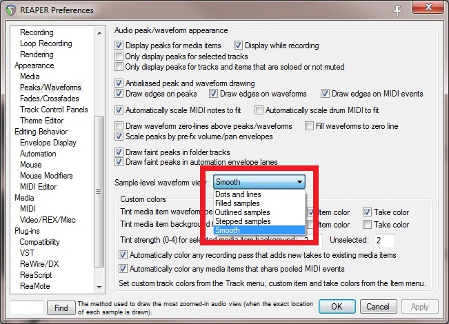

I think it's to do with this setting. (See image below) When you zoom far enough in, in track view, you can change the way the waveform is displayed. I remember with older versions of Reaper it looking more like your screenshot but now it doesn't seem so harsh when changed.
I would think that the settings for the files are saved in the .rpf files of your old project and carried over from a previous version of Reaper which is why you see it different. I don't have any old mixes at hand to check right now, but I will have a look later.

Yeah, I'm pretty sure you're on the right track with all that. I tried changing some things and some things made a difference and some didn't. But it's not affecting the sound, so I'm pretty sure it's just a visual thing. Which setting, that's still to be determined, but it's most probably just visual and nothing else.
I think the wiggly waveforms are in projects set to "Stepped samples", and the squarer ones are set to "smooth", or something along those lines.

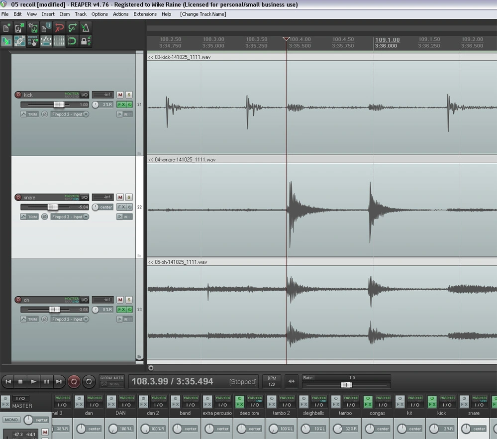

Just to put everyone's mind at ease that was so concerned about the size of my waveforms, this is how they usually look. But had I posted them like this, nobody would have been able to see what I was talking about:

And Clean also figured out the problem. I can't believe it, man, you're a genius. That's all it was. I opened a older tune with the square, defined waveforms, copied the overhead track, and then pasted it into a new project. Sure enough, it got squiggly, but sounded the same. I guess what I thought was "blurry" and "squiggly" is really just a more detailed waveform, kind of like higher resolution. That's awesome. Learn something new every frickin' day. Thanx man.

No it's just a random bass drum hit that I circled. But it doesn't matter what I circled, the whole track is smooth and defined in the first, and the whole track is blurry and squiggly in the second one.
