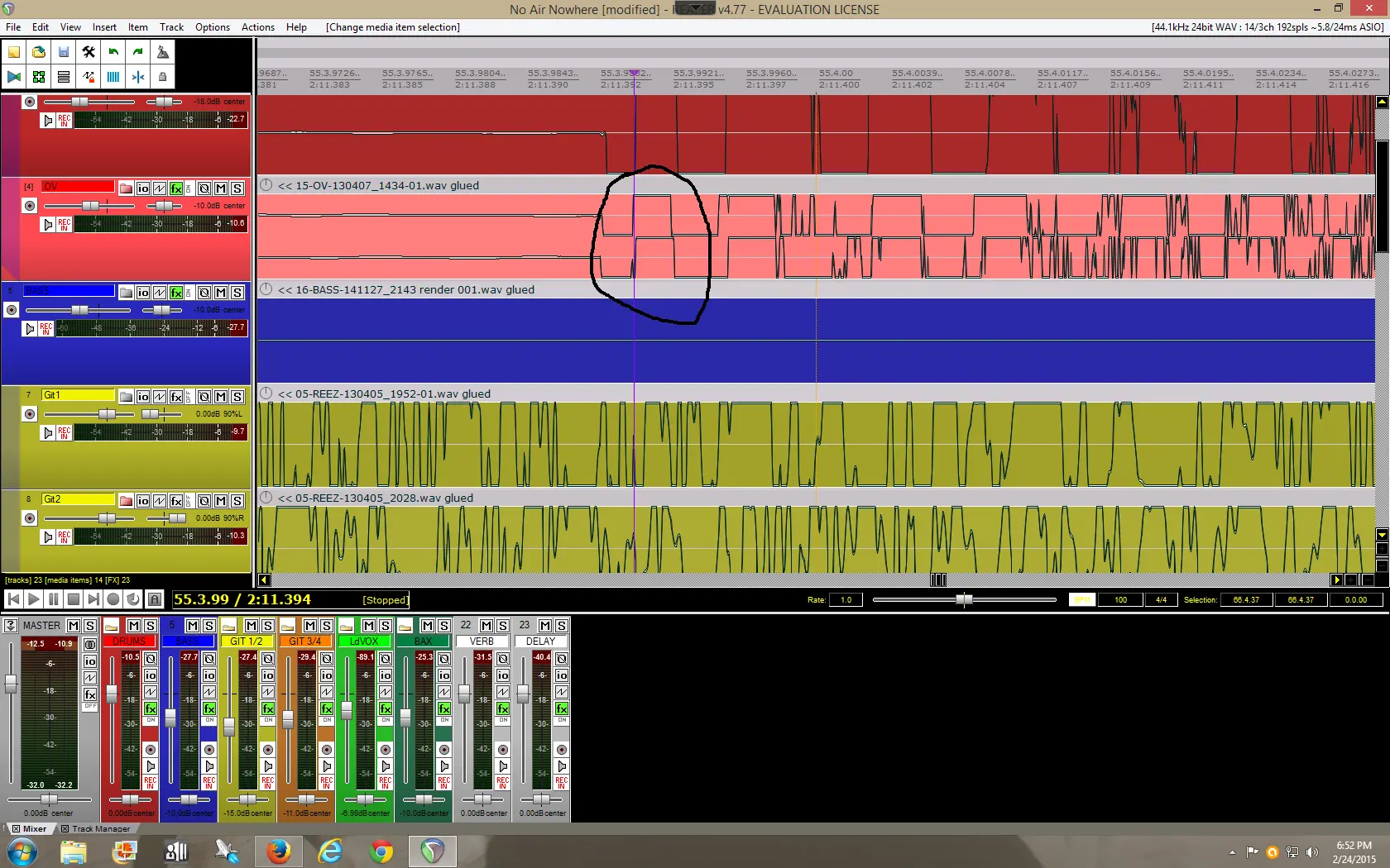

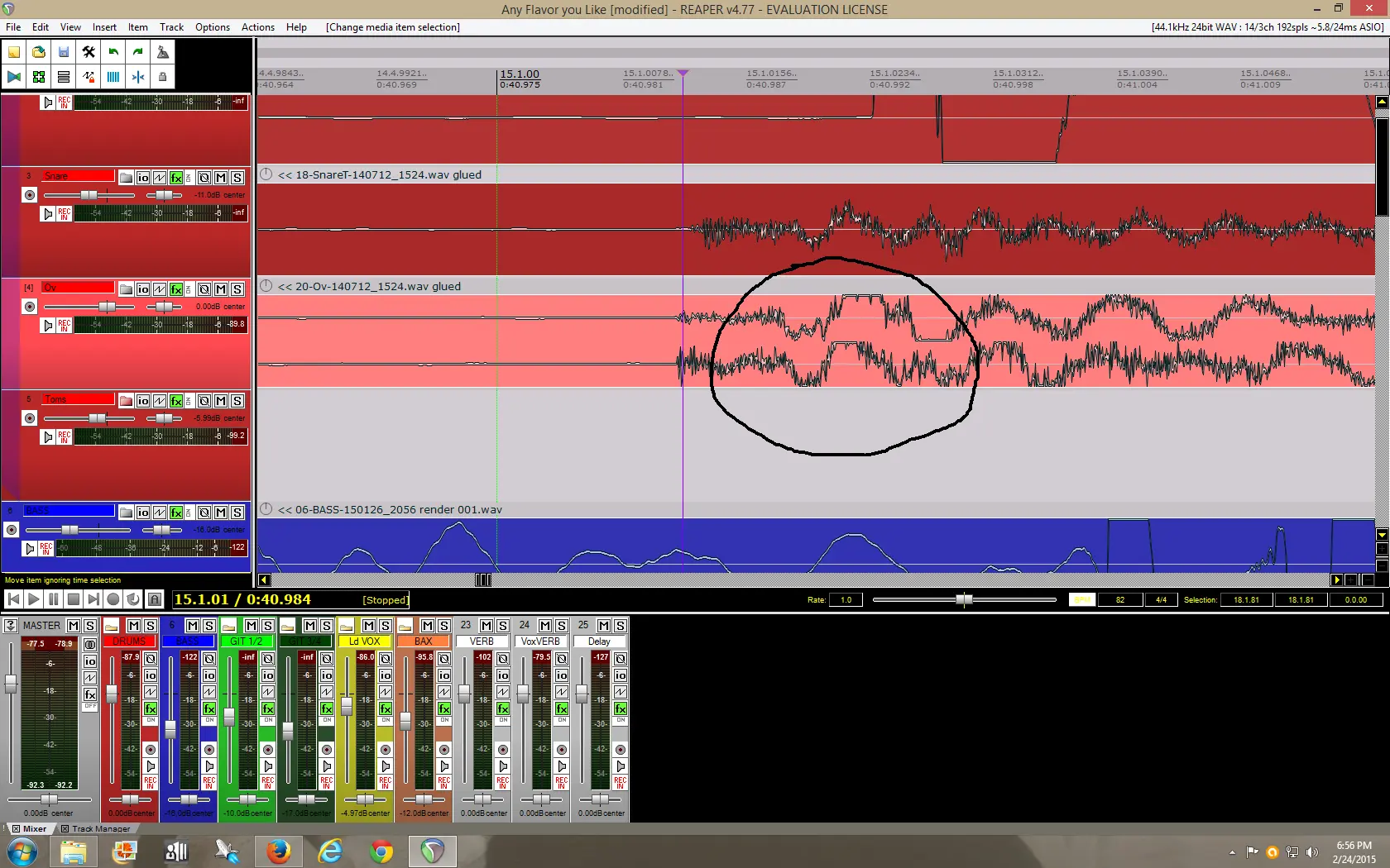

I've been wondering about this for a while now, but never knew how to ask the question. Then, I realized that the best way would be to do a couple of screenshots.
Until a few months ago, my snare and bass drum hits in my overhead tracks were well defined, square shapes, easy to line up if I needed to etc......
Starting a few months ago, I noticed that they're a lot more blurry and less defined. I don't think it's affecting anything other than how it looks, but maybe there's a reason for it. Anyone have an explanation?
Here are the 2 screen shots. First one is an older track. You see where I circled the bass drum hit in my overheads, it's a very well defined square with corners. The second one is more recent and is less defined, more blurry.

Ah shit, the shots don't fit in my screen unless I make the page size a lot smaller. Let me know if you can't see the circled hits, or just make your page smaller, they're there.

No, it's not clipped. I just made the waveform as big as possible. It's nowhere near clipping.
Like I said, I made the screenshot too big. If you slide the bar at the bottom of the actual post with the screenshots, you'll see where I circled the bass drum hits. Or, just smallerize the page and you'll see it.
They're not clipping, guys. Those tracks are probably coming in at about -14 at most. Come on, you guys know that the view in REAPER can be increased and doesn't mean anything.

I can post with a more normal view, but do you not see the difference? Look at the circles. One has a thin, square waveform. The other has a squiggly, blurry waveform. That's really all I'm concerned with. My levels are fine.
Yes...totally see the difference.
Just saying that since your question is about the look of the waveforms...maybe a more normal size view might help to answer your question.
In my own DAW, I can size up the waveform vertically like that too...but I honestly never do (I just zoom into it)...so it's hard for me to give you a clear answer if one is more normal looking than the other when they are over-sized like that. :)
Yeah no, making the waveform smaller just makes it harder to see the difference between the 2.Making the view extra big the way I posted allows us to really see the difference between the 2 waveforms. I'm just really curious to know why there's a difference. Looks as if the "blurry" one is shaking or something, but I doubt that.

Did you, by chance, create the older Project with an older version of Reaper? I seem to remember there was an option in the preferences to change the waveform view. Can't find it now in the latest release. Maybe the Project has retained the settings from an old Reaper version.
Try copy a file from the Project to somewhere else on your computer and importing the file into a New Project and see if it looks the same or if it is like a normal waveform. It should build a new .rpf file and the waveform will probably look normal.

And Clean also figured out the problem. I can't believe it, man, you're a genius. That's all it was. I opened a older tune with the square, defined waveforms, copied the overhead track, and then pasted it into a new project. Sure enough, it got squiggly, but sounded the same. I guess what I thought was "blurry" and "squiggly" is really just a more detailed waveform, kind of like higher resolution. That's awesome. Learn something new every frickin' day. Thanx man.
