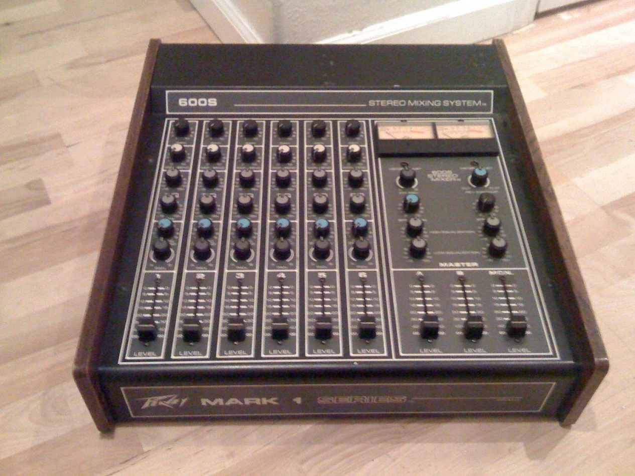

Regarding the Peavey mixer, if this is the one you have (see attached), then yes, it has mic pres too! I can't see the back panel, but I would assume it has XLR inputs, though I'm not sure about phantom power.
