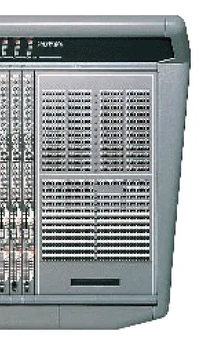

I just put in a new studioconsole, which came from fabric with all the connections on a patchbay located within the console's frame. Each channel has :
line in, mon in, send, return, group, tape send, tape return. That are 7 connections X 40 channels = 280 sockets.
The mastersection of the console has 160 sockets for 2tracks, aux, effects sends/returns, talkback, etc.
These are just the standard connections that are labeled and connected within the factory.
Next to these connections there are 96 tielines connected to interface the console with all the outboard equipment, along with 40 patchpoints coming from the recording rooms.
In the left row of 19" panels I have a 44 point patchbay (of which only 12 are connected) so I can always connect extra keyboards etc. Same for the right row of 19" panels.
So that makes a total of 280+160+96+40+88=664 patchpoints. Am I'm using hardly any keyboards in the studio.
So what the hell do I use all these patchpoints for? Well most of them are half-normalised Which means that patching the output doesn't break the normalling, and patching the input does break the normalling. So for everyday and standard use I don't have to patch much. mostly it's normalled to have a logical signalflow. Whenever I want to do something that's not standard, like routing tapereturn 40 to channel 2 I just patch it that way. This makes my studio unbelievable versatile. I can patch the mics from the recording rooms to either any of the consoles preamps, or to any of the outboard tube preamps. I can route the outputs of any of these preamps to any of the consoles line-inputs, monitor inputs or tape-sends. I can patch in a compressor whenever and whereever I want. Get the point? I don't have to patch anything. The console can operate without any patchcord inserted. It just follows the normal signal flow.
I do understand it looks very over the edge, and I stared at the patchpanel for a couple of hours before I even knew what the hell all the labeling meant, but once I start working, I figured out in short time. I just have it a couple of weeks, and wouldn't want to switch back.
Here's a pic

*LOL*... I know how patchbay connections work.... Your missing my point.... Im talking about people who don't have the gear to support having that many patchbays.... and buy a bunch of patchbays, just to fill their rack in a cheap manner...
If you have the use for it, and it works for you... by all means... have 1000 sockets.... But, I was just refering to a smaller project studio I went to recently, that didn't have the use for it, and clearly bought them just to make there control room look all techy..
They were just using a Mackie 24*4.. and one stereo compressor and one Pre (I think)... And nothing was really hooked up to the patchbays, other than the ins and outs of the compressor, and the ins and outs of the board....... Even the adats bypassed the patchbays and went directly to and from the board..
And there were like 500 friggin sockets... THAT, is what I was talking about :D..
I meant it lightly, try not to read too much into my ramblings.... Cause thats all they are... Ramblings :D
