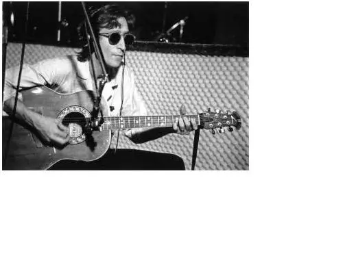

here's a acoustic - guitar pic, maybe an idea.
