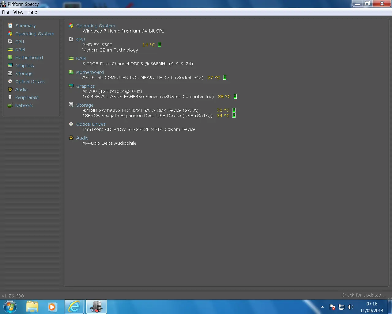

A few years ago I bought a W7/64 HP tower and was aghast to find it only had one PCI slot. This scuppered my plan to install 2 M-A 2496 cards and have 4 in 4out from a Teac A3440.
So when XP died I was looking for a new PC (I have 4!) and built the attached. I have not stressed it unduly so far but the PC seems remarkably swift and stable. Quiet too bar a slightly clicky HDD which I am going to sleeve.
Do note that the Asus MOBO does NOT have integrated graphics but you don't need anything very garish for audio work. I paid about 30quid for one from Maplin but only because I was eager to get going I could have bought something just as good on 'Zon for 1/2 that.
I have used 3 2496 cards on 2 W7/64 PCs, nay bother.
