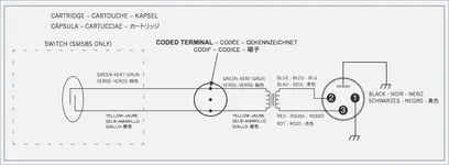

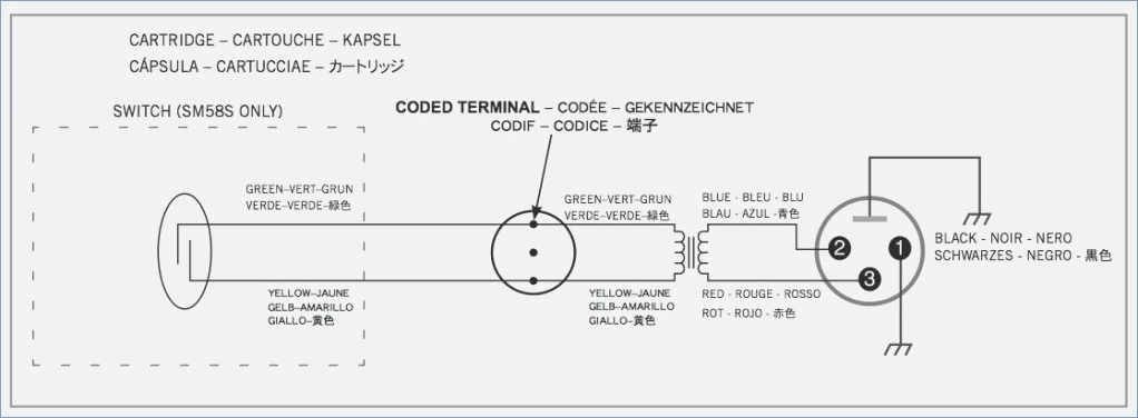

Just drop the transformer out of the circuit shown below of an SM58 and it should give a balanced connection to the mic. Having the 'ground' of the cable connected in any way to the coil of the capsule might prove not too healthy for the mic if phantom power got accidentally applied.
