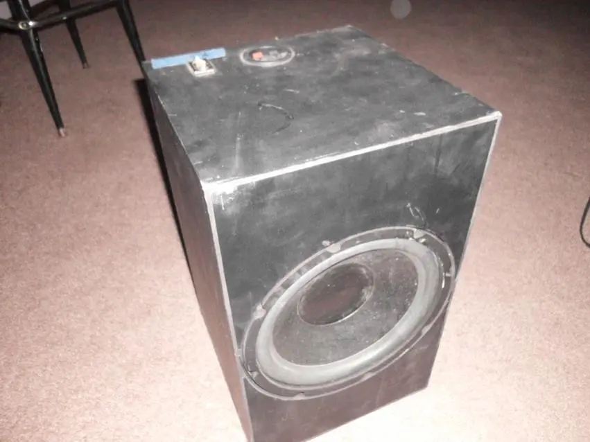

Here is a pic of mine. Just wired a XLR jack to a $10 thrift store sub. Needs an inline 20dB pad.
Jimmy,
Is that a sealed enclosure? Just wondering how in depth this is gonna be.
And to be honest, it just never occurred to me to have an enclosed speaker for my subkick. Maybe that's why I didn't hear much of a difference.

A pad is indeed needed!
So it seems that an enclosure can/will effect the performance? Yamaha has theirs in one so it makes sense. They made it look like a mini kick drum...............wonder what (if any) effect might be had if I made a mini horn load?
