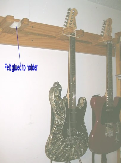

Have you tried felt, I used it on my guitar rack where the neck contacts the hanger and used contact glue to keep it in place. It keeps the necks in good shape, I got several 8 x 11 sheets of it from the Hobby Lobby store for about 11 cents each.

That looks great randy! I'm totally making something like that, I outgrew my 5-guitar stand a couple guitars ago. That's WAY nicer than some off the shelf on-stage stand or whatever.. Thanks for the motivation :D

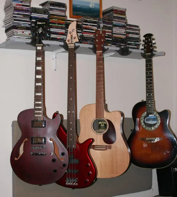

"Off the shelf"??? How about On the Shelf?? I cut notches into a shelf and lined them with pipe foam (I think similar to Randy's liner). Two shelf brackets are screwed into the studs in the wall. It's very strong. I also covered the shelf with fabric, but that didn't come out very well and I will probably do something different when it gets near the top of my To-Do list. never.

I have that same yammie bass in blue. Love it! :cool:
