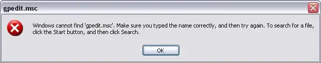

EDIT: It suggests run/gpedit, which for some reason doesn't work for me.

For the gpedit be sure to include the ".msc" extension in the run command ...i.e. gpedit.msc
Your way isnt too bad for a small number of users. There probably is a utility for this though, I just don't know what it is.
Yeah, i tried it. That's what i got(below). I've started my way, and it's ok. I'll just do it for my account and copy my settings to my mums. I don't want too much running on mine either, so it ashouldn't take too long.
