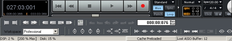

haha No, I donut find this a problem in Linux, either. And, we don't hear about this on a Mac, but that's how it sounded to me. Does the Apple version of your DAW have any usage/overload indicators - pasted around the extreme top or bottom ?
Luckily, I have no end of glitchy computers pulling 100 % CPU to snap a 200 percent something
