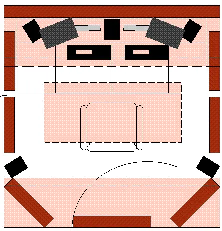

So, would you suggest it in my wee shed studio, lol? Remember, my room's only 6 1/2' x 7 1/2' and will be terrible acoustically. I will be adding a lot of, especially bass, absorbtion though.

I will be adding lots of absorbtion. I don't have much money so can't afford superchunks. Will stradeling the corners be enough? I can only stradel 2 of the 4 vertical corners though, due to space, but will be stadelling wall to ceiling corners too. I will be using ultratouch which has pretty decent absorbtion down to 125Hz(0.95 at 125hz, apparantly)and will be building the absorbtion panels so as to leave a lot of the side of the insulation exposed too. One other thing that screws it up even more is that i wanna mix in 5.1 surround, lol. AND that a lot of my equipment will be Behringer hahaha. What do you expect? I'm a student. I've got no money at all, and many many dreams, lol. Check the attached pic to see my control room plan.

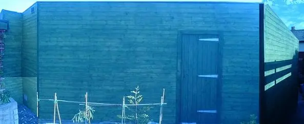

And this is a badly put together pic of what the front and sides of the shed look like now. Compared to what the front looked like.

Hey Pandamonk, don't fret. Your doing just fine. Use what you have, learn the most you can with it and don't worry about it. This is SUPPOSED to be fun, remember? :p Your plan looks very good and I bet your recordings will be just fine. One of these days you'll be able to look back and say..I did THAT with THAT???? :eek: :eek: :D :D Cool. Man, I wish I had even a smidgen of what you know and have when I was your age. Don't laugh, but I'm SIXTY ONE :eek: and STILL ain't done with my room....good grief. Will I ever grow up :rolleyes: :p ;)
