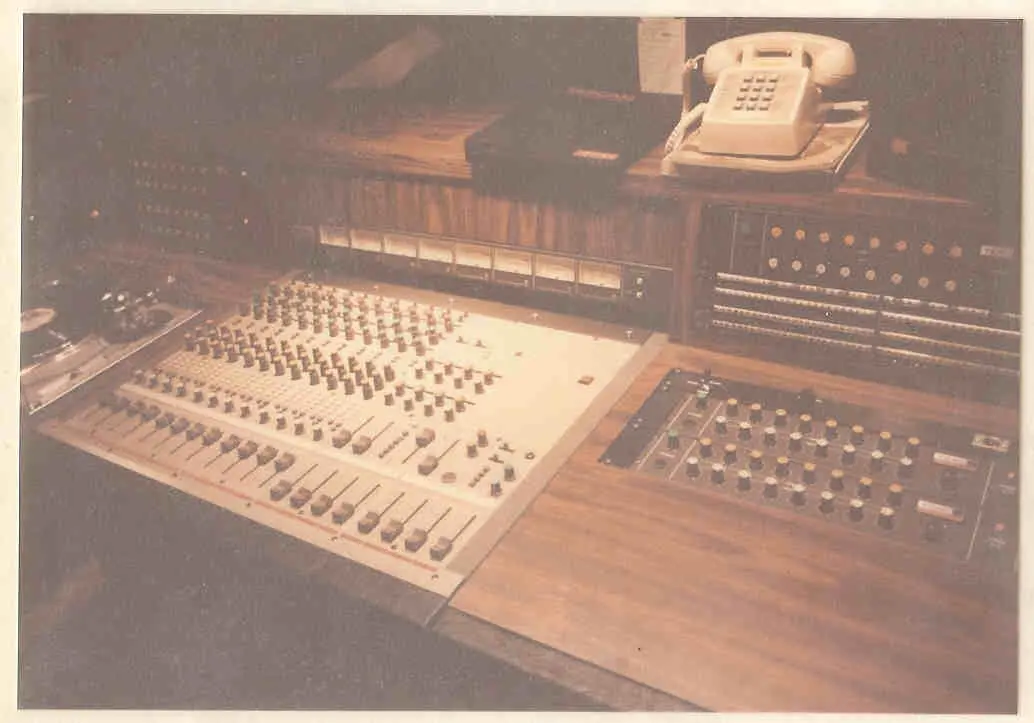

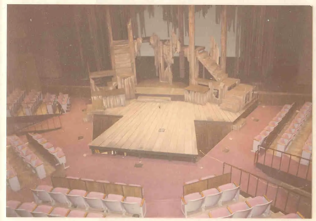

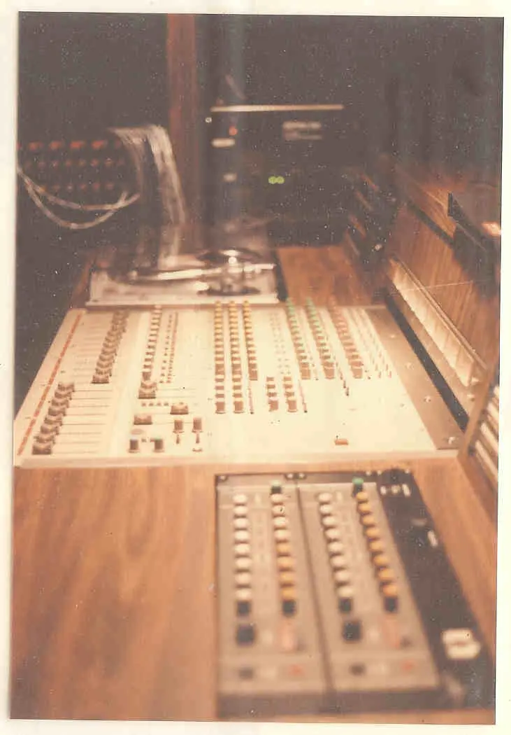

Here's a theater system that I designed MANY years ago using Model 1B's as matrix mixers to the theater speakers.
