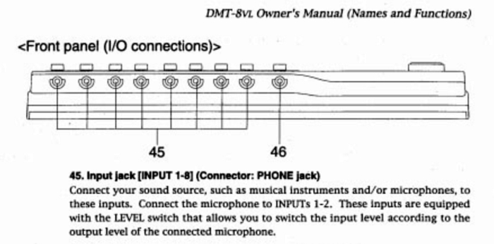

I'm sure Instrument level is real enough. I just don't have anything(keyboards) that specifies that. The late '80s Kawai would of been suitable for lounge entertainment and the manual says plug it in to the Kawai KM60 keyboard amp, public address system, or audio amplifier .
I've got instrument switches on some hardware recorders and on some interfaces, but I've never used the switch for keyboards. A lot of the switches just say guitar, or the Combo jacks say auto sensing for MIC, guitar, line ? Plenty of my inputs just say plug in your instruments;
