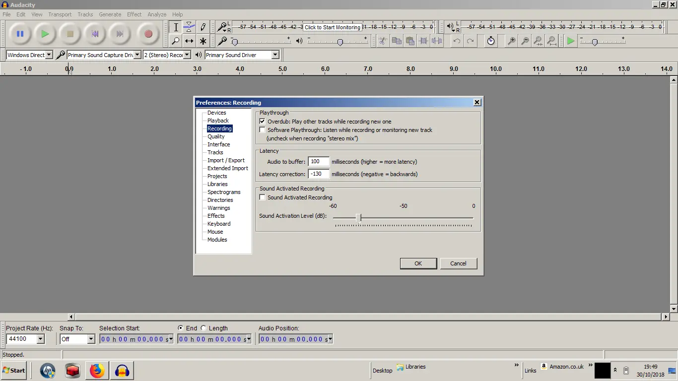

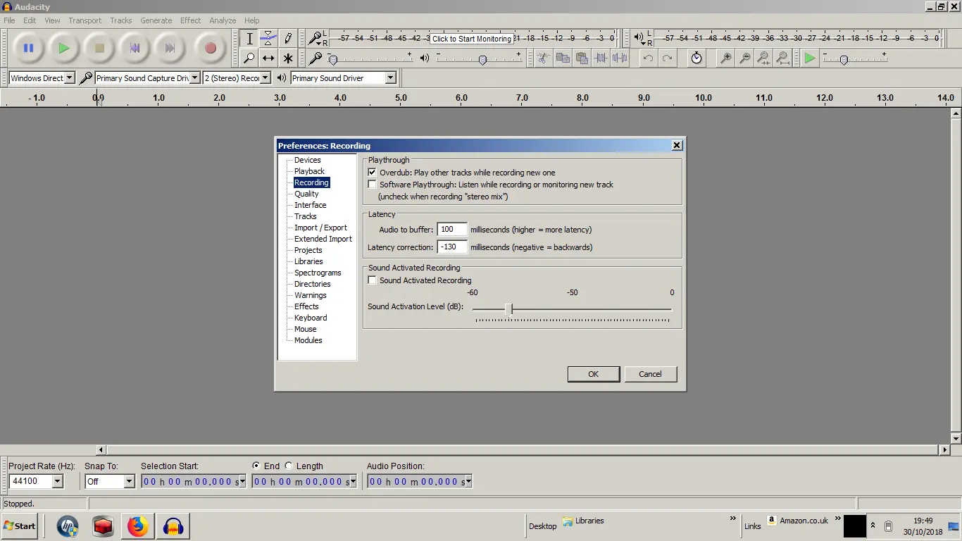

I suspect you need to turn something off in Audacity. Will have a look.
I suspect you need both of those boxes unticked.
Other than that is could be a routing problem in the mixer. If indeed the mic is picking up an acoustic signal? It will, nothing you can do about that except stop the noise or get very well away from it.

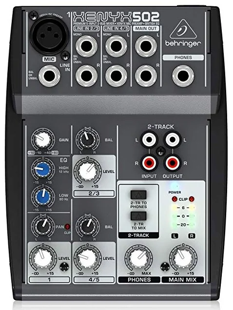

Is this your mixer?
Yes.

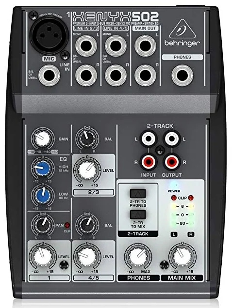

THe line out form your computer - where do you have that plugged in on the mixer? The '2 track' input? If so, you don't want the '2 track to mix' button pushed in.

I have a 3.5mm on the line out of my computer to dual 1/4 inch mono on line in 4/5
I have tried connecting my audio out from my computer to the 2-track input though - with and without both buttons depressed - and it did nothing except in some variations made the sound so quiet it was almost inaudible.

Unfortunately that's not what I'm trying to do. I may try cutting out the 2-track all together and plug the main out into the mic input.
Ok- I am definitely confused then about what you are trying to do here. I am not sure the Main Out to Mic will help. If you are dumping your computer signal from it's line out, into the mixer via dual 1/4" on 4/5, how are you routing signal TO the computer for discord or OBS, as MJ and ECC mentioned may not work with your set up?

Okay I've done some more experimenting and I think what's happening is that the input from my computer into the mixer is getting caught up with the output of my mic from the mixer thus whenever I play audio on my computer it cuts off the audio from the mic and routes back into the computer via the mic jack. I honestly don't know wtf is going on and I'm almost ready to say its faulty hardware. If there is anything I can answer to help clarify my new findings please ask away.
Also if I use 2 RCA cables in the 2-track both connecting the the headphones and mic jacks on the computer the issue stops (other things start happening though) but I can no longer hear my voice in my headset unless I push down one of the 2-track buttons and then my issue starts again
