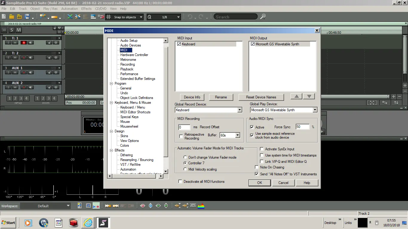

Don't have S One but yes, there is something similar in Samplitude below.
In Cubase e.g. you can set (or not) "Use system timestamp". Might be moot?
Mmm...that's for aligning your MIDI sync, it's not the problem he is having.
I've been using Samplitude for a long time...never had this kind of issue where recorded tracks are not in sync with existing tracks.
