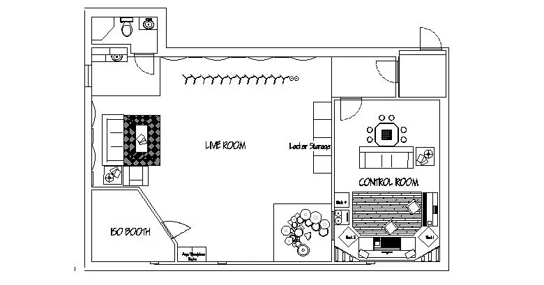

i started putting the polycylindrical diffusors up in my studio last night. i got one whole wall done. (the one with the mic stands along it) and i plan on doing the one behind the couch. i do not need to do all 4 walls, do i? i see larger studios and it seems as if they typically only do one wall... i must say, these things look really cool. i used 1/8" plywood with an ash veneer. i can already tell there is alot more high end without all the foam in there. i dont have any flutter echo either. they are really easy to do too. i had 3 of them up in about an hr.
here is a floor plan of what i am doing.

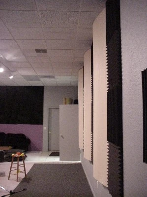

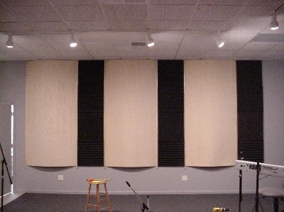

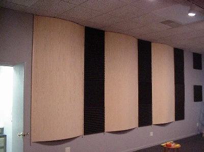

i will get some pics of the wall i have done over lunch...
here are some pics. it was as easy as fastening rails to the walls and bending plywood between them..
another...........
and lastly........
Nice job!
Don't they need to be sealed on the top and bottom?
