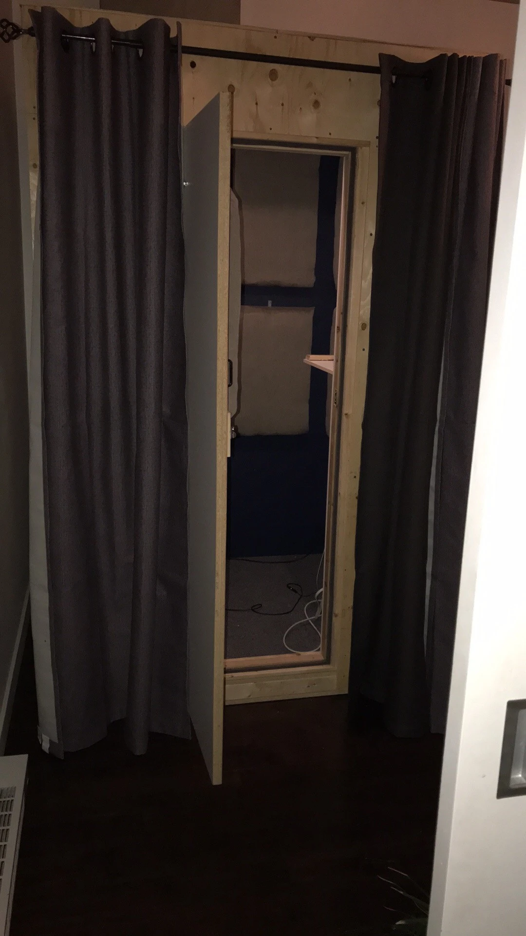

Critique/comments on my future vocal booth please....

Just about finished, and I have to say I'm blown away by the results. Yeah she's not much to look at, but wow does it ever do the trick.

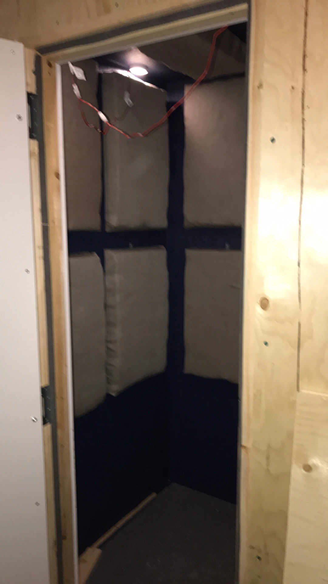

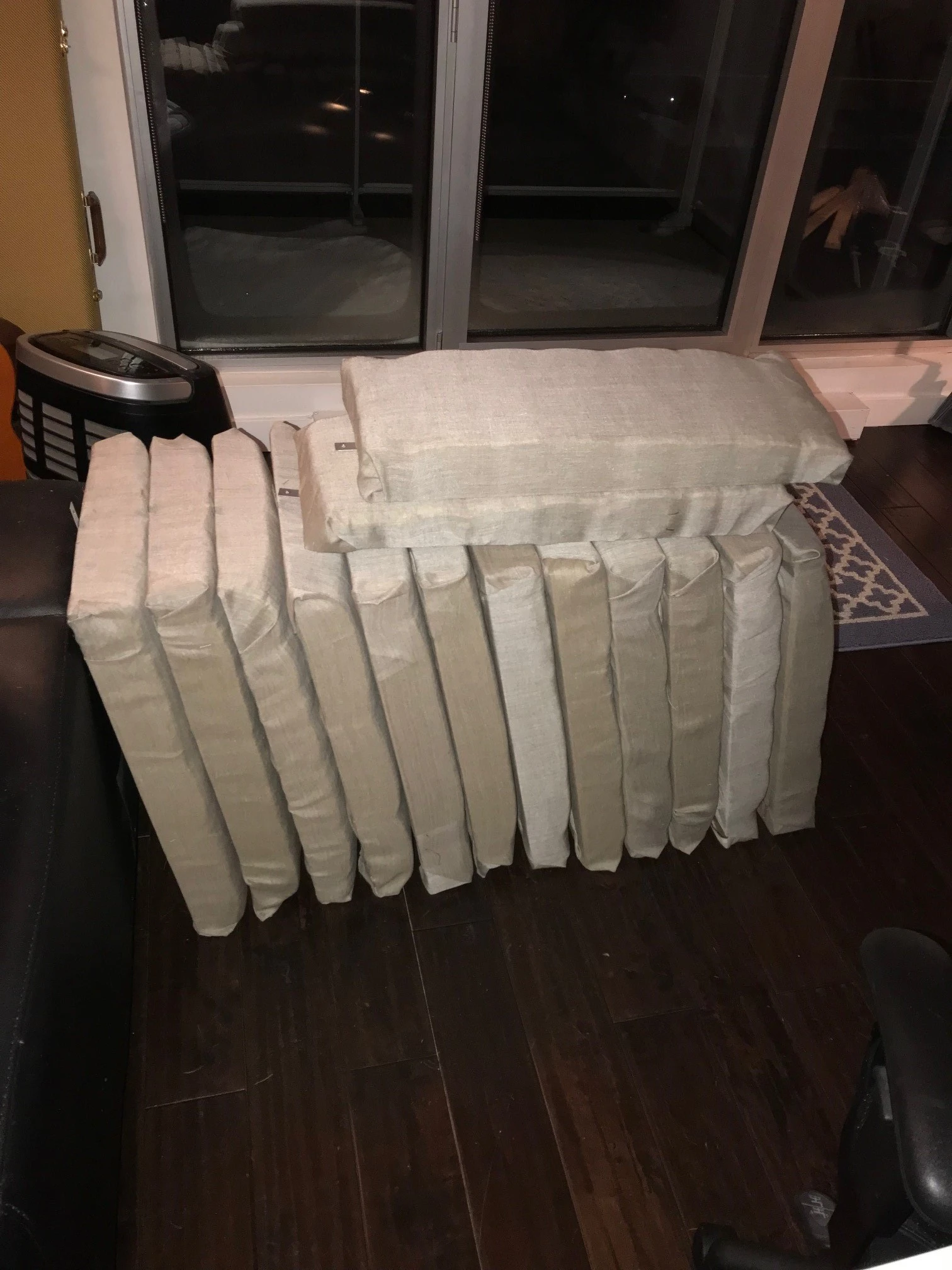

Even with me screaming inside, the sound outside the box booth is substantially reduced. No more worrying about neighbours, that's for sure. I also made a bunch of (lumpy) 3" rockwool acoustic panels and put them on the walls and ceiling. The difference it makes in transforming the sound from boxy and terrible to nice and dry (not sure what the term is , but it's now dead in there...I like it)
Have only had a few chances at recording a few tunes. I'm very impressed with the results. However, the air gets stale and hot in a matter of minutes, so the weekend I'll be sure to install my ventilation fans.
Anyhow, I'm very happy I went through with this. Most people called me crazy, but in the end I got exactly what I wanted.
