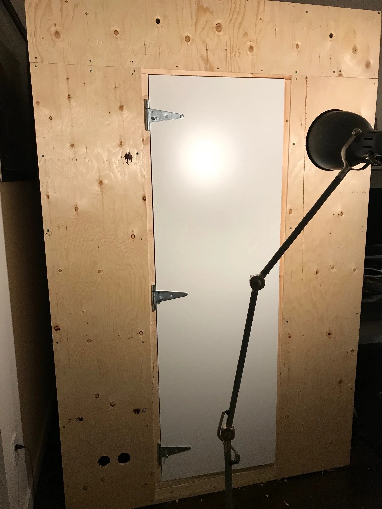

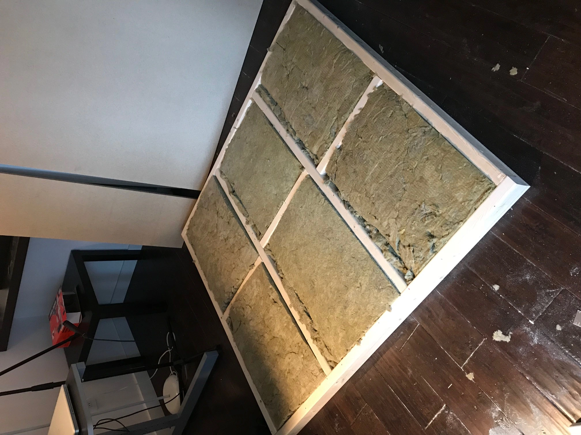

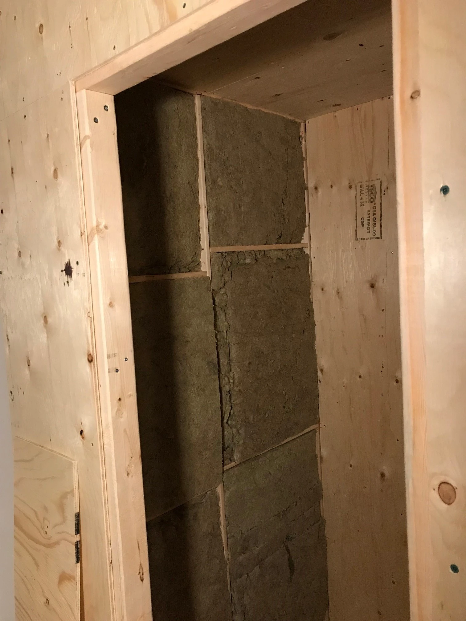

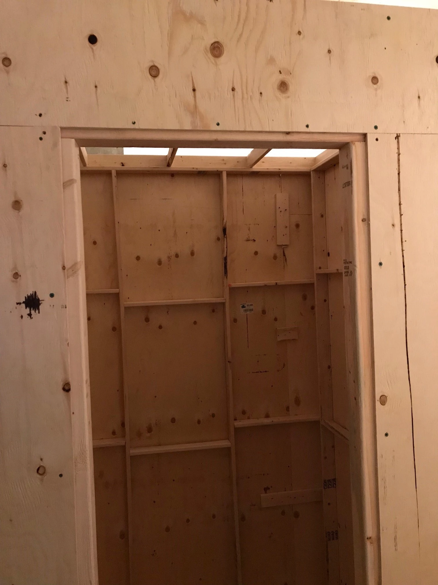

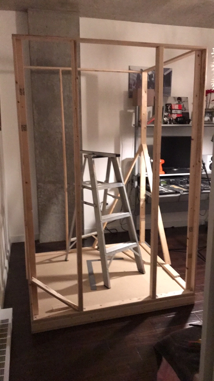

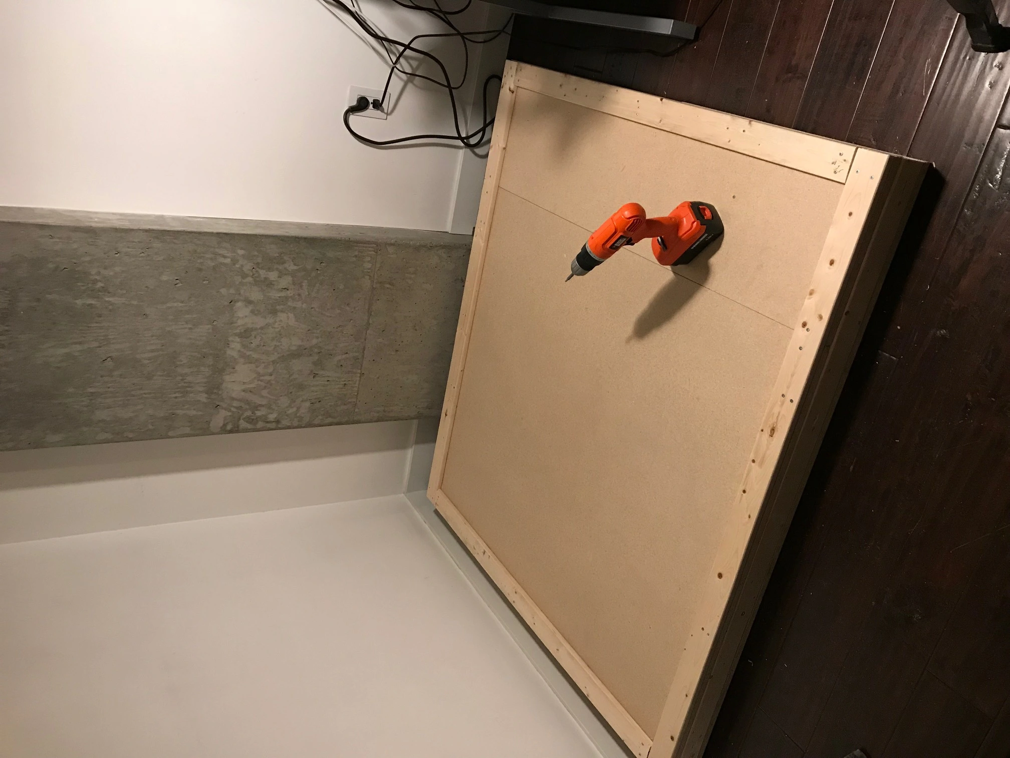

I live in a condo, and looking to build a non permanent booth. The purpose is to keep my vocals quiet and not disturb the girlfriend, and to a lesser extent the neighbors. Creating a non closed vocal spot, or using a closet is not an option. My singing is too loud. Also, I want to keep my place looking nice. So I figure after this is all painted white, it won't be an eyesore.
I was thinking of the following:
- interior dimensions 4x4x6.5
- half inch dry wall in and out.
- 2x3 wall studs, filled with 3" of soundproof rockwool (walls, floor ceiling)
- door will be a hinged insulated piece of wall (It'll be well sealed...I'll figure out a way)
- I'll also figure out some sort of ventilation system.
- LED lighting system
At this point the build will run me about 300-350 Canadian dollars...not bad,
Here's where it gets pricey:
If I want to line the 120 sq foot interior with 12x12x1" or 2" foam panels, it's WAY too much money.
Could I instead line the interior drywall with foam but space them out, this way I have to buy a lot less panels? Another option?
Anyway, would love to hear what you guys think.
Thanks in advance.
