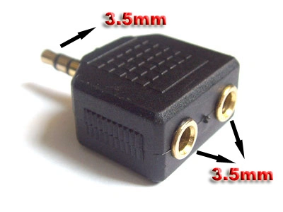

Hi guys. I own a Presonus Firestudio Mobile and wanna know if I can get ouput on the creative sbs a520 5.1 surround speakers through the head phone jack. Knowing the fact that all 5.1 PC speakers have 3x3.5mm cables for output connection, I will be using two 2 way splitters. Please tell me is this can work or not. If not, than please suggest another way. I can not afford studio monitors at the moment so this is the cheapest option avaiable. The splitter is the one in attachment. Thanks.

It wont work for a few reasons.
1: A headphone output wont power speakers unless they're active speakers, and even then it's not ideal.
2: You won't get 5.1 audio even with amps or active speakers, because the source is a stereo output.
3: Even if you did it with amps and were happy to have stereo sent to three sets of speakers, one of those sets will be centre+sub,
so you'll have left out the sub and right out the centre, or vice versa.
Do you want genuine dolby 5.1 output from something, or do you just want to run your 5.1 speakers as front+rear stereo plus sub?
Let us know and we'll see what we can do for you.
