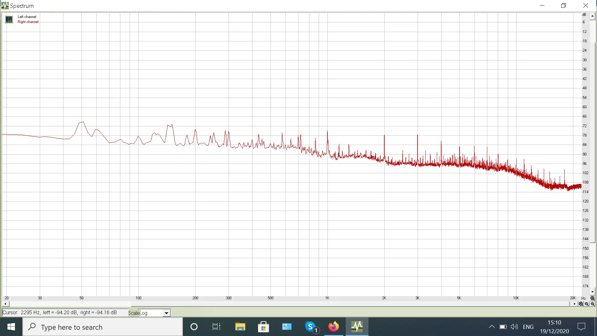

when trying to record using Audacity/Cakewalk there is loud white noise/interference (file attached)
It is most pronounced when first running my guitar through my amp and then into the UMC22 however it is also present when i plug my guitar directly into the 1/4" jack input or when i plug my shure SM58 into the xlr input.

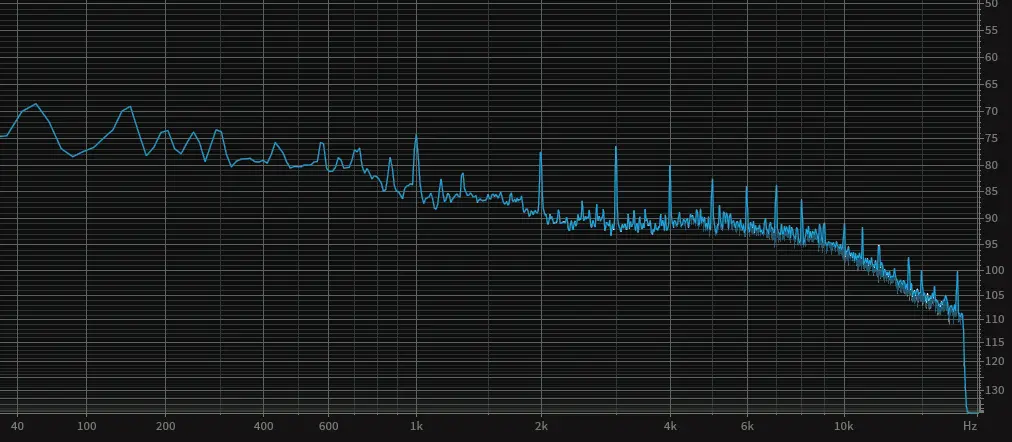

RMAnny is rather easier for my old eyes! Now that looks very much likel the spectrum you get of those cheap ass converters you get in budget mixers! They centre the 'hash' bang on 1kHz and make a general mess everywhere.
However, OP says it is temperature related? That in itself seem a bit sus'? A (desktop?) JUST running two tracks for an AI should not get hot. I would use a program likwe "Speccy" to investigate what is getting hotter. Maybe a dust buildup?
