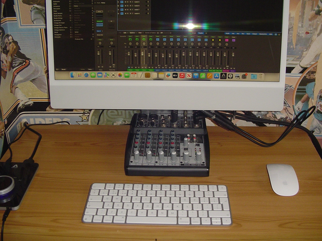

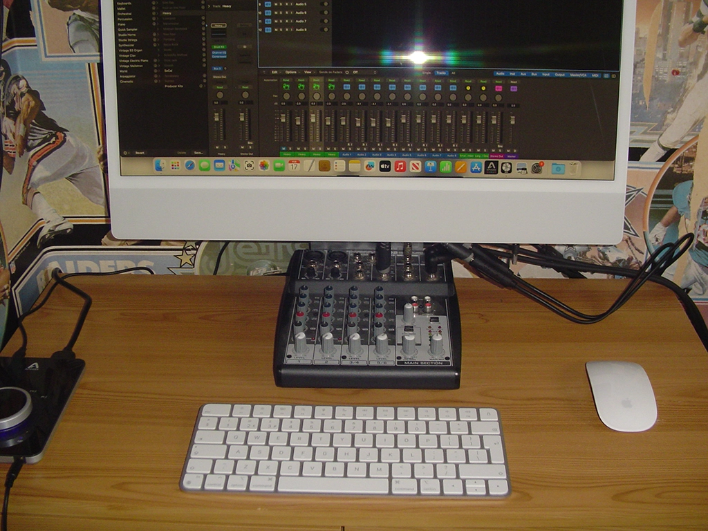

Thanks Dave. The mixer in question is the Behringer Xenyx 802. The dusty specimen can be seen in this photo!
Hah!Ha! I shall hear nothing against the 802! I have one in my back bedroom and it has been relaying garden sounds from a pair of mics without fail since 2012 to a recorder in my living room. Never been turned off!
Yes, I an sure I can find you a diagram for that wee beastie. There you go, if the pots and switches crackle a bit invest in a can of WD-40 Contact cleaner. LOT cheaper than De-oxit!

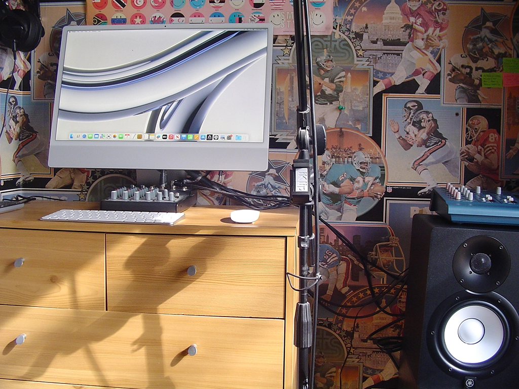

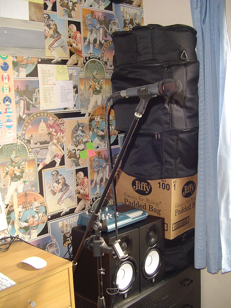

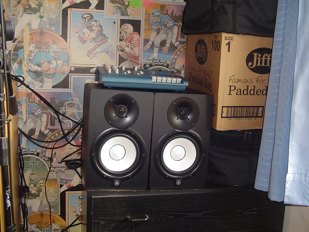

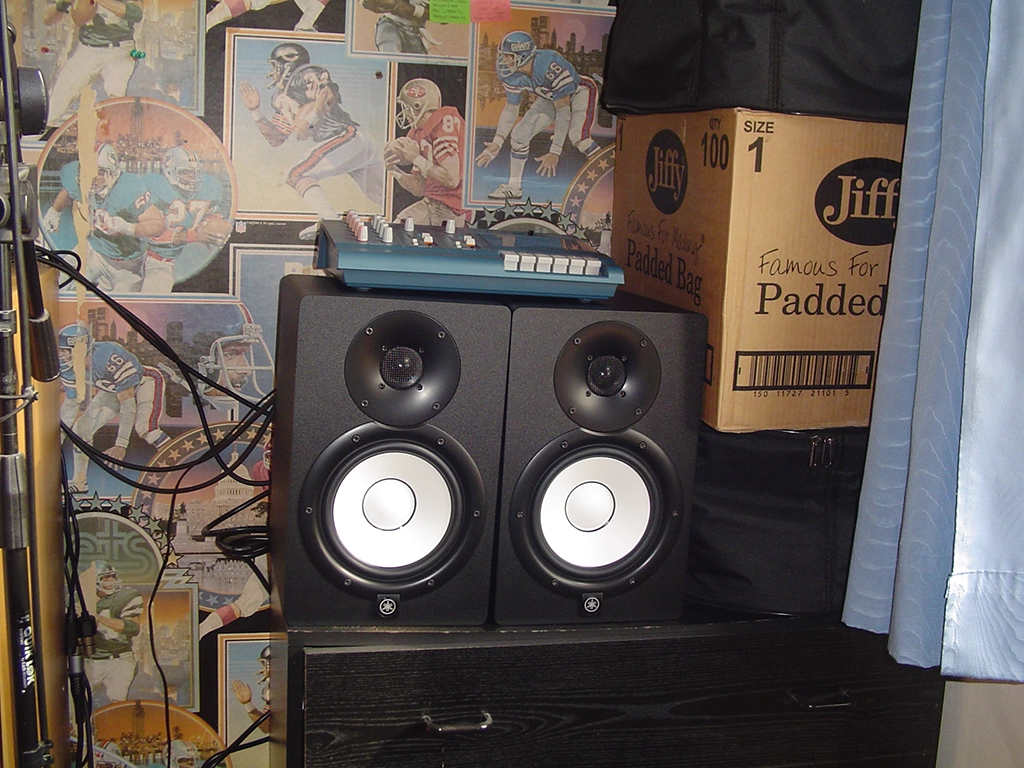

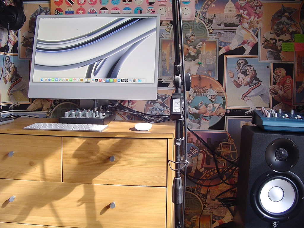

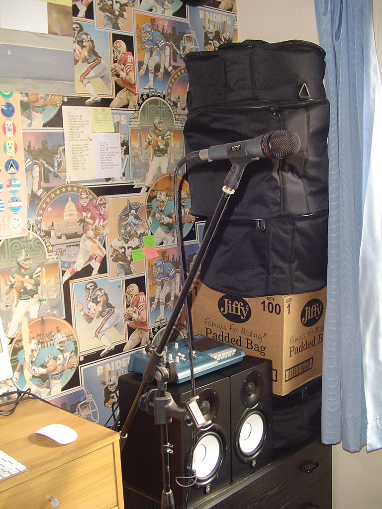

This worked very well! I’ve only got one so far. I’ll get the other one after my next pay day. I set it to -4db on the room control just because I’m in a small room. It sounds pretty good. I also like the light on it. That looks cool!
On a slight negative note, it doesn’t fit on my desk! They are much bigger than I had in mind. Instead they will go on a nearby set a draws. I’ll upload a picture when I get the other one. :-)
I’ve got the other one and I can report it all works brilliantly! I'm delighted with the result. Like I said, they were much bigger than I imagined so I had to put them on a nearby set of drawers and right next to each other which isn’t ideal but they sound great. I’ve also had to pile my mate’s drum kit up precariously next to them with a box of envelopes! As long as that dodgy stack doesn’t topple over it’s all good! Thanks again for your help. :-)
