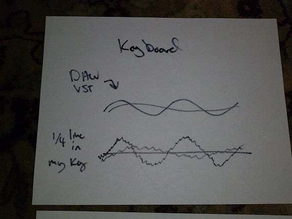

2nd a midi keyboard . This is already in a vst for the DAW. I am not trying to bring my sounds in, these are their's. Very smooth good looking signal that sines out.
View attachment a1.mp3
Here is a one note signal , in there DAW vst midi and it is super clear , sines like a dream..
View attachment siga1.mp3
If I plug in my keyboard as a 1/4" input it doesn't look like that , or sound like that. Conversely the guitar plugged into the 8 track sines out beautiful.
Here are 2 more clips to get the point across. Please visualize with window media player on o scope or similar. If youre not here, this is the only way to illustrate.
1st a guitar direct with nothing average -8db . Not even a hint of sine wave , albeit a guitar signal.
Here is a one note signal , in there vst midi and it is super clear , sines like a dream..
If I plug in my keyboard as a 1/4 input it doesn't look like that , or sound like that.

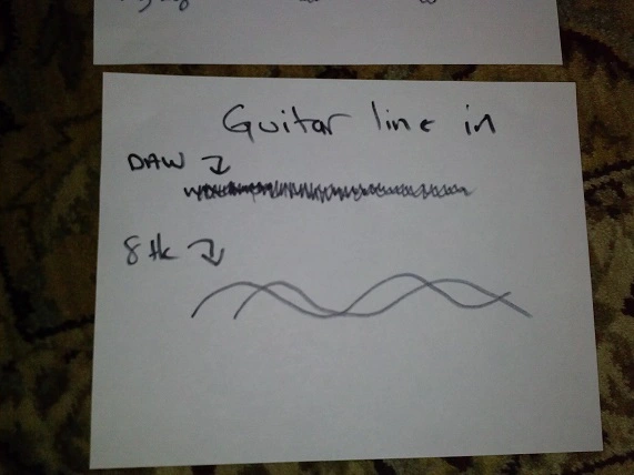

Oh yeah, but convinced because it cant record it. And, I have the RTA physical equipment to analyse it.
I tried to record video on my phone, or capture a wave in picture but it is difficult. So I drew it.
You know what a o scope represents, right?
Whats this as a raw input? No it doesn't (please tell me youre testing me for some weird reason). Will it sine out and fill out sonicly with something I don't know about yet? I think if that existed it would be on page one of the manual.

Yes. If I input the keyboard 1/4 in the sine wave goes stepped and looses all live quality.
But you guys are telling me , the guitar just needs eq . It needs WAY more than that. It lost its whole waveform going to digital. Now the line 6 box has some vst to go direct. This is an improvement on the guitar daw sound.
The small "jagged" waveforms are high frequencies and the the wide smooth ones are low frequencies. Although the waveform does suggest a bright sound, the sound tells you that on its own.
If it's a guitar with a passive pickup then the tone may be suffering from an input that doesn't have a sufficiently high impedance, a trait which generally causes an overly bright tone with little low frequency content. That seems surprising for a guitar oriented interface and I couldn't find any technical specifications with the input impedance so I could be off base. Nonetheless that's how your guitar sounds through that gear.
Another possibility is that you're used to the loss of highs that might be caused by some imperfection in the tape recording process that's no longer occurring when you record on the digital system and you're compensating with a high boost somewhere in the system. It may be something habitual and automatic that you're not even aware you're doing.
Perhaps try cutting some highs with a shelf or low pass filter.
