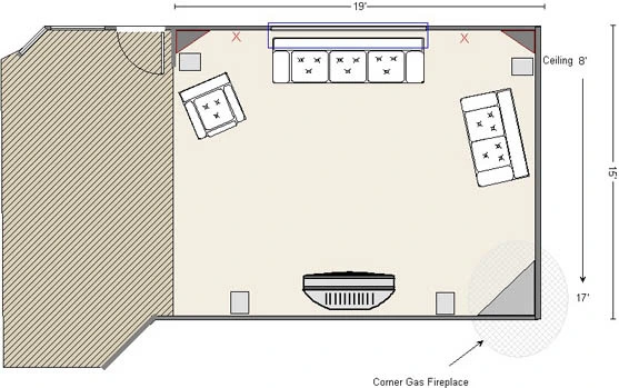

I attached a pic of the layout. <again this is for home theater but we all could learn from it>
I was thinking on building a trap in each corner <like shown> by just screwing a 2x2 into each wall, filling with insulation, and then putting ply on an angle.
Ethan, are you suggesting to put another trap where you see the red X's?
What about some sort of bass trap under the rear window behind the couch?
I was thinking about some sort of diffuser on the east wall to break it up since the opposite wall is open and the room is not symetrical.
Thanks for the help.
Ron

Ron,
> I wouldn't be able to pull off the kind of treatments that I saw in your room. ;) <
I understand completely. But then you won't get the high quality of sound I enjoy! So try to sneak them in a few at a time. With any luck the family won't even notice until it's too late to complain! :D
> I was thinking on building a trap in each corner <like shown> by just screwing a 2x2 into each wall, filling with insulation, and then putting ply on an angle. <
Fine, but forget the plywood.
> are you suggesting to put another trap where you see the red X's? <
I'm suggesting you put in as many traps as you can manage. The more you install, the flatter and tighter the low end will be. Walls are good, especially the rear wall, and corners are even better.
--Ethan
