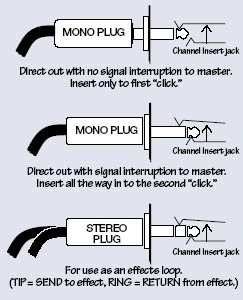

"The insert jack can also be used as two different types of direct outs.
If a tip-sleeve 1/4" cable is plugged all the way in to the second click, the signal is sent out from the tip (output) of the insert jack and does not return to the ring (input), which breaks the loop and does not allow signal to flow through the rest of the channel. This is referred to as a direct out with signal interruption. if a tip-sleeve 1/4" cable is plugged in only to the first click, the signal is sent out the cable and continues through the channel, since the insert loop has not been broken. This is referred to as a direct without signal interruption."
Also, see attached the diagram from the 1604 Owner's Manual.
As for the question about where is the sleeve connected, it's still connected via the sleeve contact. With a TS cable going one click into a TRS jack, the tip of the plug is clicking only so far as the ring position in the jack; i.e. since the plug is not going in all the way to the second click (the "tip" contact in the jack), the normaled signal through the channel strip is not interrupted and the direct signal is being tapped out through the ring contact on the jack. But because it's a TS plug, the sleeve is immediately behind the tip and is still connecting to the sleeve connector in the jack. Nothing lost there, and the circuit is still completed.
"One click, one click only." - Sean Connery in "The Hunt For Red Rocktober"
G.
