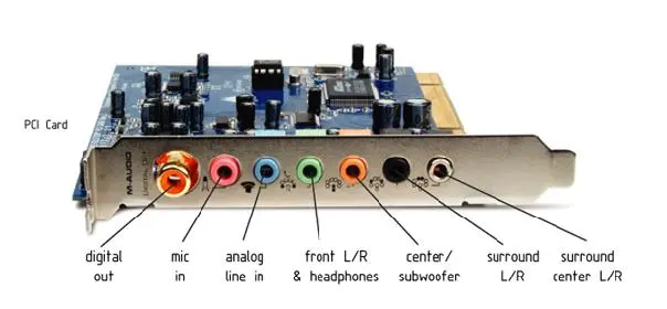

I Googled the card and came up with this image. If this is your card then run a 1/8 Stereo plug from the FRONT l/r into whatever your KRK RP5's use for input plug. You may need some kind of adapter cable to split the signal into two lines for your monitors....
What about using the digital OUT?...and is using the L/R Front 1/8" the best way to connect it during recordings for monitoring and stuff (also during mixing)?...Also, should i connect it to the unbalanced or balanced ports on the monitors?
You can't use the digital output on the card because your monitors don't have a digital input.
You would use the unbalanced input oon the monitors.
You might want to think about getting a recording card, that one is more for gaming and movie watching.
