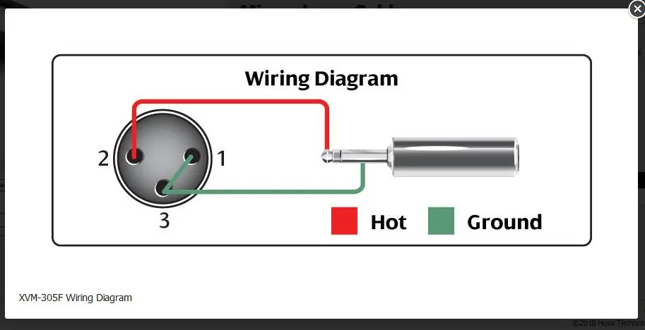

If your going to chop and solder you want to use a TS type plug that's wired sort of like below. You'll want to tie the wires together that come from pin 1 & 3 of the XLR together and solder those to the sleeve connection of the 3.5mm plug and pin 2 to the tip. This creates an unbalanced mono connection to the mic input on your computer.
Alternatively if you don't have a TS plug handy, bridge the ring and sleeve connections together on the 3.5mm TRS plug and connect pin 1 & 3 wires from the XLR there. If you need me to sketch that up I can.
In most computers the ring connection of the jack may provide a low bias voltage for cheap electret mics that do not have a battery like the mic you have. That connection is not intended to carry audio signal from a plug that has a ring connection of a TRS plug.

Thanks Arcaxis! That makes sense, I should have a ts somewhere here, I'll do what you described, thanks for the sketch too!

It worked Arcaxis! Since the adapter already had a trs on it, i just re-soldered the wires how you said, and bridged the ring and sleeve connections. It's not awesome quality, but it works!
