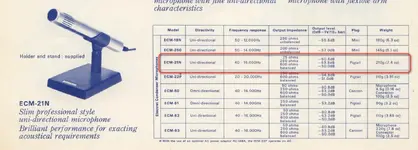

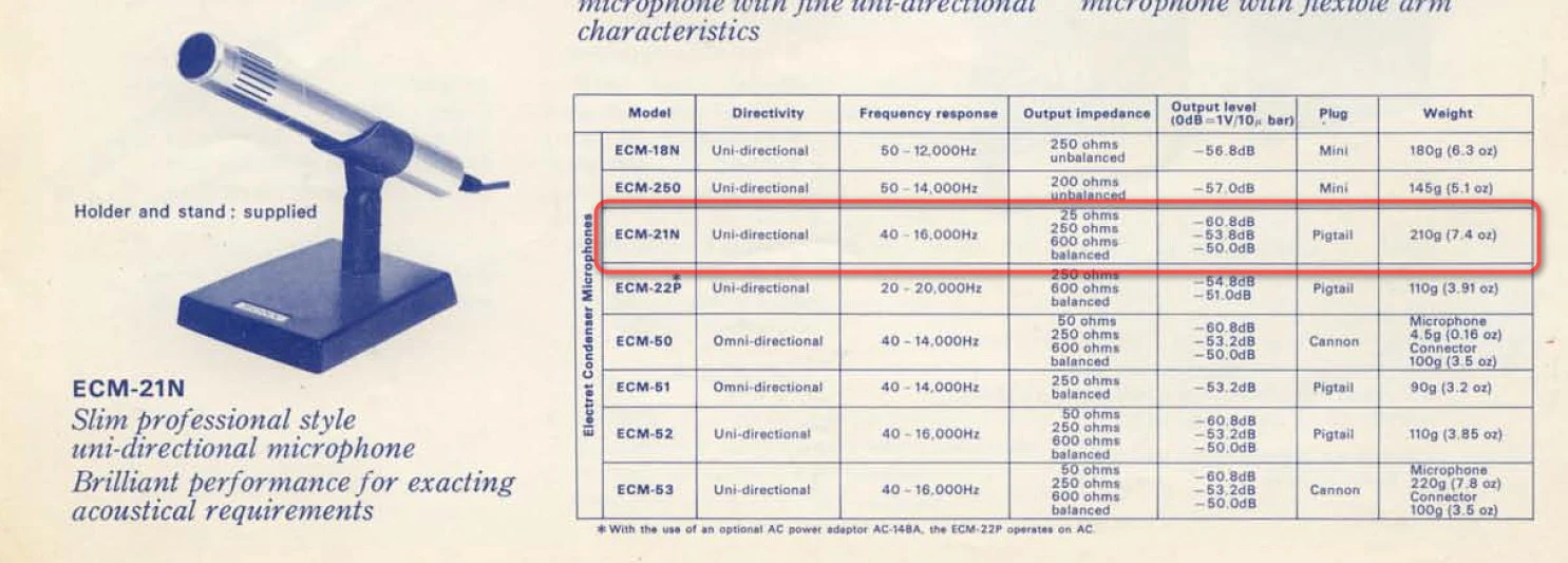

Evidently 'balanced'. Found and old Sony Video Equipment catalog with this mic. It notes having 3 different choices for impedance which I wonder how that is selected(?) Maybe the 'pigtail' provided the wires to select impedance(?)
Well waddayoukno. That's a first. Thanks for looking that up. Not easy to find info 'bout these mics.
Is there a transformer or was Sony using a different capsule in this model?

Too many to reply to separately now, but seems like the problem might be that it is set to high impedance currently. I researched briefly online and found that the signal strength of high impedance mics drop of very quickly when on a long cable. And the cable on mine is about 6 meters long! (EDIT: it cant be the case, according to that catalogue for the mic the max impedance is 600 ohms, with is still considered low impedance).
And thanks arcaxis! That image is very useful. It looks exactly like that, and it is the 21n, but it doesn't have a pigtail connector (whatever that is?), it has a cannon. Now, i just need to work out how to switch it, and if it is the case.
