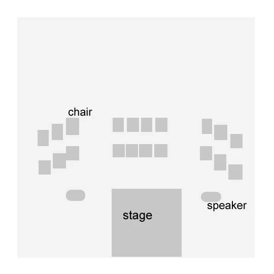

Looks like my "diamond" idea would cause more complications than it's worth. I'll probably go with something like this:
Take care to note that in live sound, "coupling" of the low frequencies happens at what would normally be the listening position in a studio setup.
Try to move your speakers far enough apart so that the distance between them is the same as a spot behind all audience members from each speaker. This will make the coupling happen behind the audience, and will make the mix more even across the "front" of the audience.
You would not believe how often I have gone to outdoor festivals where the sound system company didn't take this into account. What happens is that you get this huge bass in the center of the audience area, and very little bass out on the "wings" of the audience. :( When I have to mix in this situation, I have to figure out where I want the bass to sound right. If people are not flocking to the front of the stage, then I make the "wings" have enough bass. But if people are in front of the stage, the "wings" will have very aneamic low end. I don't like that at all (either way), but I can not very well require the sound contractor to setup their subs in a proper manner 10 minutes before I mix eh? LOL
If you are using a full range speaker setup, then you will have to use distance between the boxes to move the coupling farther back. If you have seperate subs, you can often solve this problem by facing the subs out towards the wings of the audience. Outside, subs become far more "directional" than they are inside.
Have fun at the gig.
