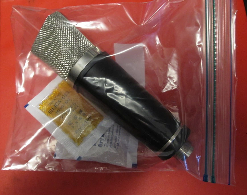

Humidity? Damp capsule can act up in that way. Place it in a Ziplock bag with some desiccant packs for a day or so and see if that clears it up. I've had a couple mics (Lauten LA-220 and a CAD M179) exhibit noise on humid days.

We have had some humidity here recently, for sure, as you know.

One of my 414's started doing this - and I got the bag with desiccant solution here. I was sceptical but with nothing to lose and a minim £100 repair bill, I popped the mic into a bag with a few packets of silica gel and left it in my central heating boiler cupboard for a few days. It went away!
Wish I had some silica gel... Its drier out today, maybe put it out in the sun?
Lacking silica gel packets, you could try dry rice. Put the rice (maybe 1/4 to 1/2 cup) in a nylon stocking and tie it closed so any small bits of rice husk don't get into the mic. Place in Ziplock bag with mic. While it might work putting it out in the sun, I'd be cautious as to not get it too hot.

FWIW it took about 3 days with desiccant to totally dry out my CAD M179 and the desiccant pack did change color. I now store it in a plastic bag with a small desiccant pack. I have an AKG Perception 200 I got for about $40 and it's a decent sounding mic.
