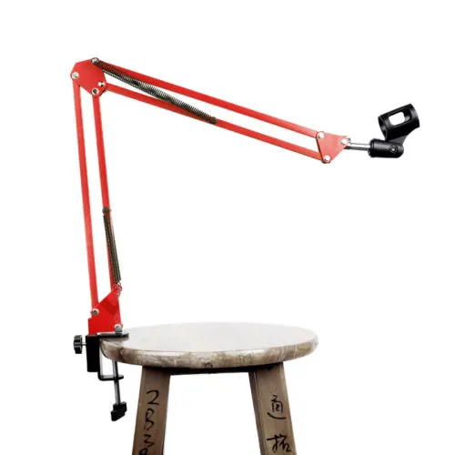

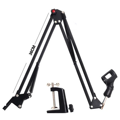

Hey.. I'm wondering, I wanna buy a stand for my condenser mic, but I want the stand to connect the ceiling.
Like.. A boom hand stand but instead of being on the floor, connect it to the ceiling.
Is it possible?
the stand i mean:
thanks so much!

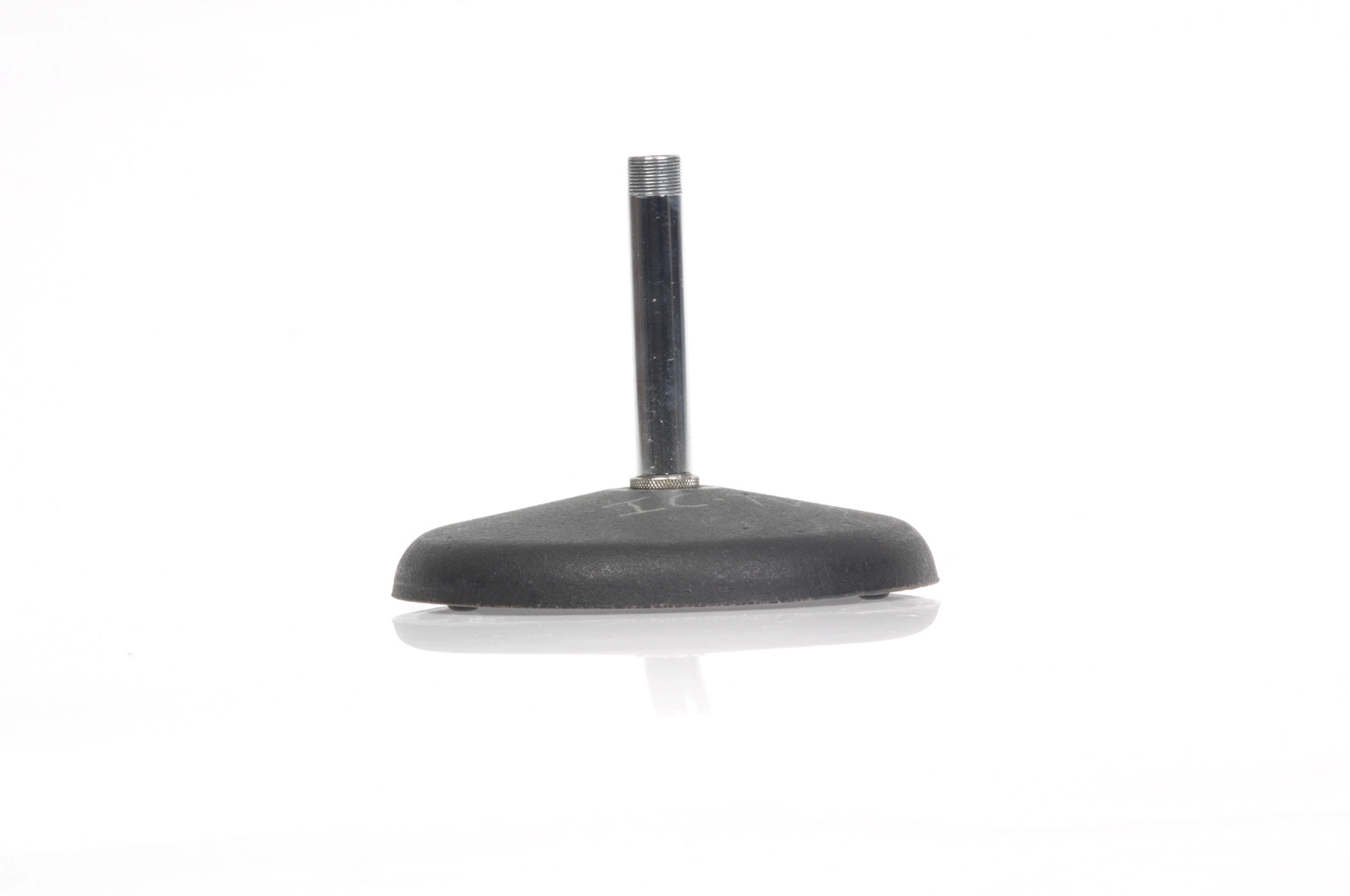

If you use a mic stand that has the heavy round bottom base, the bottom of the upright piece is threaded, just find a corresponding female part that can be attached to the ceiling joist. Note that it is going to be 'stuck' in that one location, though. I think floor stands are much more practical.

The male part is the upright of the stand. The female thread is in the base. I don't know what the thread size is, but it probably is a standard pipe thread size.
⅝″ 27 threads per inch (tpi) Unified Straight thread (UNS, U.S. and the rest of the world)
¼″ BSW (uncommon in the U.S., used in the rest of the world)
⅜″ BSW (uncommon in the U.S., used in the rest of the world)
Above are the general mic stand threads and they are different from pipe threads (mind you, the USA/UK/EU makes the whole situation a clustercluck)
Your best bet is a brass tube boss of the type used for wardrobe rails then get a small engineering shop to make you a reducer to fit a standard mic stand pole.

HERE'S the sort of boom arm I mentioned. There are other manufacturers but this is the brand I've used in the past.
You don't say where you are, but (if in the USA) I know that B&H sell them--though I'm sure there are other dealers.
Anyhow, as you can see there's a whole system with the screw on plate, extensions if necessary, the boom arms and so on.
Having said all that, I'm kinda with those who have said that a ceiling mount could be a bit limiting, depending on what you're trying to achieve.
