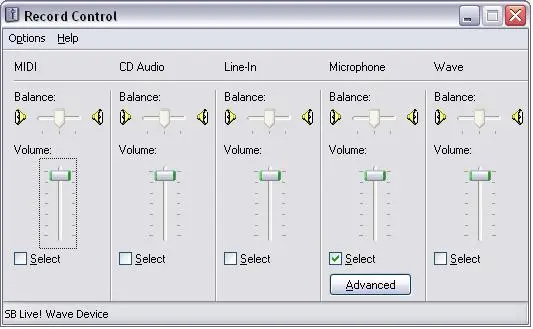

And that is the only selection you can pick." that nothing in that section is greyed out. In the Sound Recording area, do you see a volume button?
If you do select that volume button and a window called
Record Control (like the image I uploaded).
Notice the box with the word Select? The input you are using needs to be selected.
Hope this helped.
