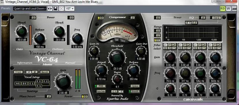

My advice is record with various settings until you find one (or more) that do the job you want. I use 4:1 , -28db Threshold, fast attack (10 ms) and medium release 350ms or so for my vocals. That may or may not work for the OP but it's a start to work with. Record sections of the same song with various settings and listen as they play back to see what you like. Post on one of these forums for advice too.
