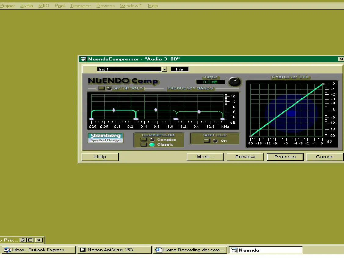

Take a look at the attachment. Note the left hand side of the graphic, see the scale along the bottom? Those are frequencies.
That's why I thought it was frequency related.

What you have here is a multiband compressor which are essentially three compressors for the three frequency BANDS. So when you set the left most compressor to a ratio of, say, 3:1 Only the bass (0 Hz to the end of this band, in your picture's case approx. 260 Hz) gets compressed (above the threshold) with 3:1. The rest of the spectrum remains untouched.
Why this technique is so usefull is still kind of a mystery to me to, as I didn't get the chance to work with ons yet. I think these babies are popular as main compressors, ie. on the main mix.

Multi-band compression is frequency-related that limits its compressor functionality to a given frequency range.
But that's not the common reference when you use the simple term compression (which implies full-frequency application).
Multi-band compression is the correct term.
EZP.
As you noted, multiband compressors are used to compress certain frequencies while not compressing others. For example, this is useful on the main mix where you don't want your kick and bass compressing the sustain of your cymbals. Thus, your mixes are clear and clean when compressing the lower frequencies.
