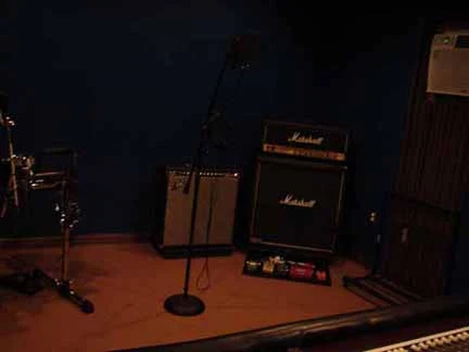

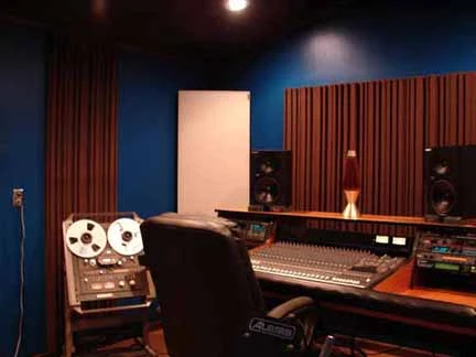

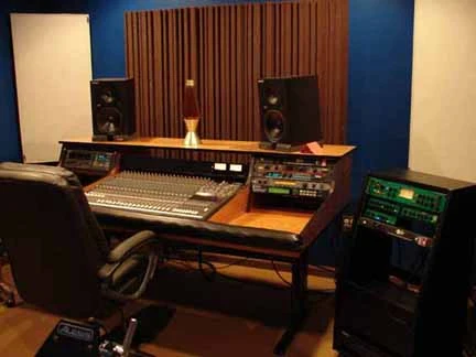

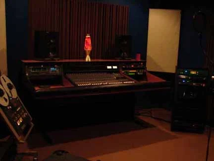

I finally finished my little project I started last summer, minus a few more interconnects of cable. One room recording and mixing, 12'x13'-6" interior, decoupled walls and floated floor. I still need two more bass traps for the back corner and foam on the back wall, but here is what it turned out to be.

Too bad* that my wife is passed out on the couch, cuz that gives me some serious wood. Absolutely beautiful. I love the lava as the focal point too.

i really like it, looks cozy and warm, very clean, i bet your clients will be impressed!
whats the mixer you're using? a mackie?
Looks fantastic. It looks like you have a Mackie 24.8. :)
What desk is that you are using? Is it custom made? If so do you have plans you wouldn't mind sharing? :D
Also, does the bridge over the mixing console get in the way of the connections, Phantom pwr buttons, and mic/line selectors? It looks like you may have allowed enough space behind to get back there to make those adjustments id needed.
Looks good - nice job. So how does it sound?
Bryan
Thanks Bryan, Earworm. I've only tested drums so far, but it sounds honest. Not a lot of echo or exaggerated bass that I can tell of. Of course, I still have two more traps to order for the back and foam that is on order for the back wall, possibly a cloud above mix position to add. The sides and front wall are treated. I may fire up the guitar amps this weekend and give a little more ear testing.

I built the desk myself to house the 24.8. There is a thread from about a month and a half ago about the building. The only plans I had were impromptu scribbles for dimensions. I used 3/4" Oak plywood in 4X8 sheets, #12 wood screws, angle brackets, 1/4" lag bolts to attach the wood "dividers" to the bottom plate, and 1x12" pine for lateral stabilizers between the legs. It is sturdy, but man is it HEAVY!

I have a question. Is that rack DIY? I talking about the slanted rack to the right of the desk. I ask because it looks like a rack that I built for my joint.

Beautiful shade of blue... what's that called?
It is 'Jazz' by Glidden paint company. Chose it for the shade of color, not the name ;), but it is a cool coincidence.

Awesome man. Hey are those diffusors or a fabric w/ a pattern that looks like diffusors?
