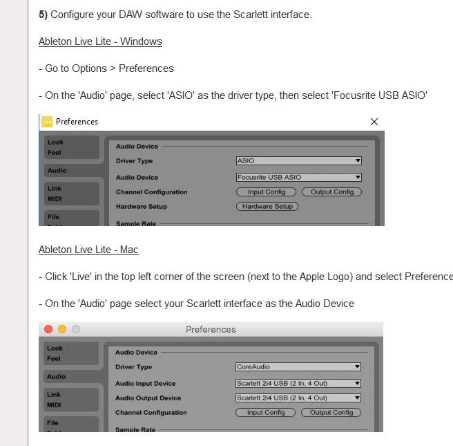

Are you using the Focusrite drivers and have the Focusrite 2i2 selected as the input source in your DAW similar to the image below

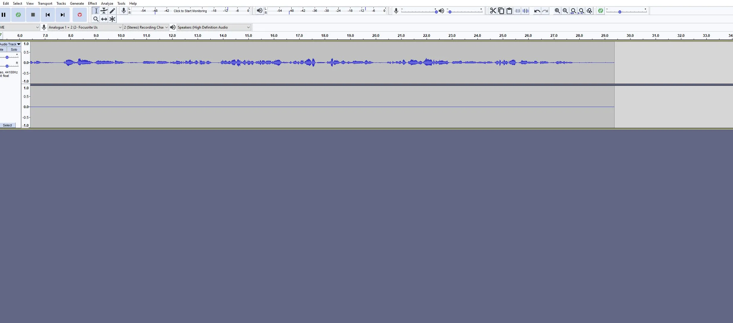

Yes I updated the drivers a ew days ago on the Focusrite website and here's my audacity screenshot
---------- Update ----------
Do you think the audio level is low then?

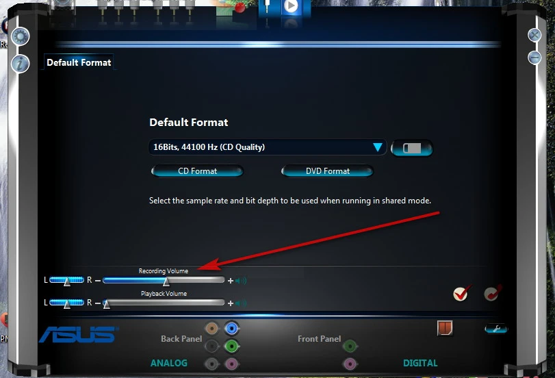

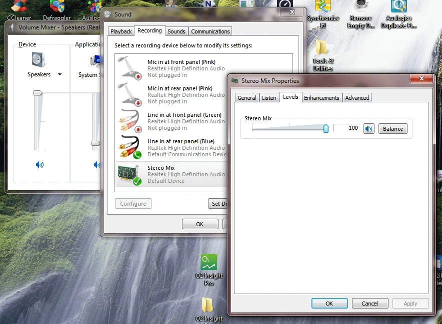

Audacity can not use the Focusrite ASIO drivers or any ASIO drivers due to copyright restrictions. I'm not 100% sure the 2i2 drivers are ASIO either or they handle the audio some other way. You might somehow be going through the Windows audio or your motherboard audio which may be have a volume/gain control in its audio system. The two shown below have gotten me messed up on occasion. Win7 audio settings for recording and the ASUS audio settings.

It's low compared to what I normally hear of other mp3's. I usually end up normalizing/boosting the audio I record in Audacity.

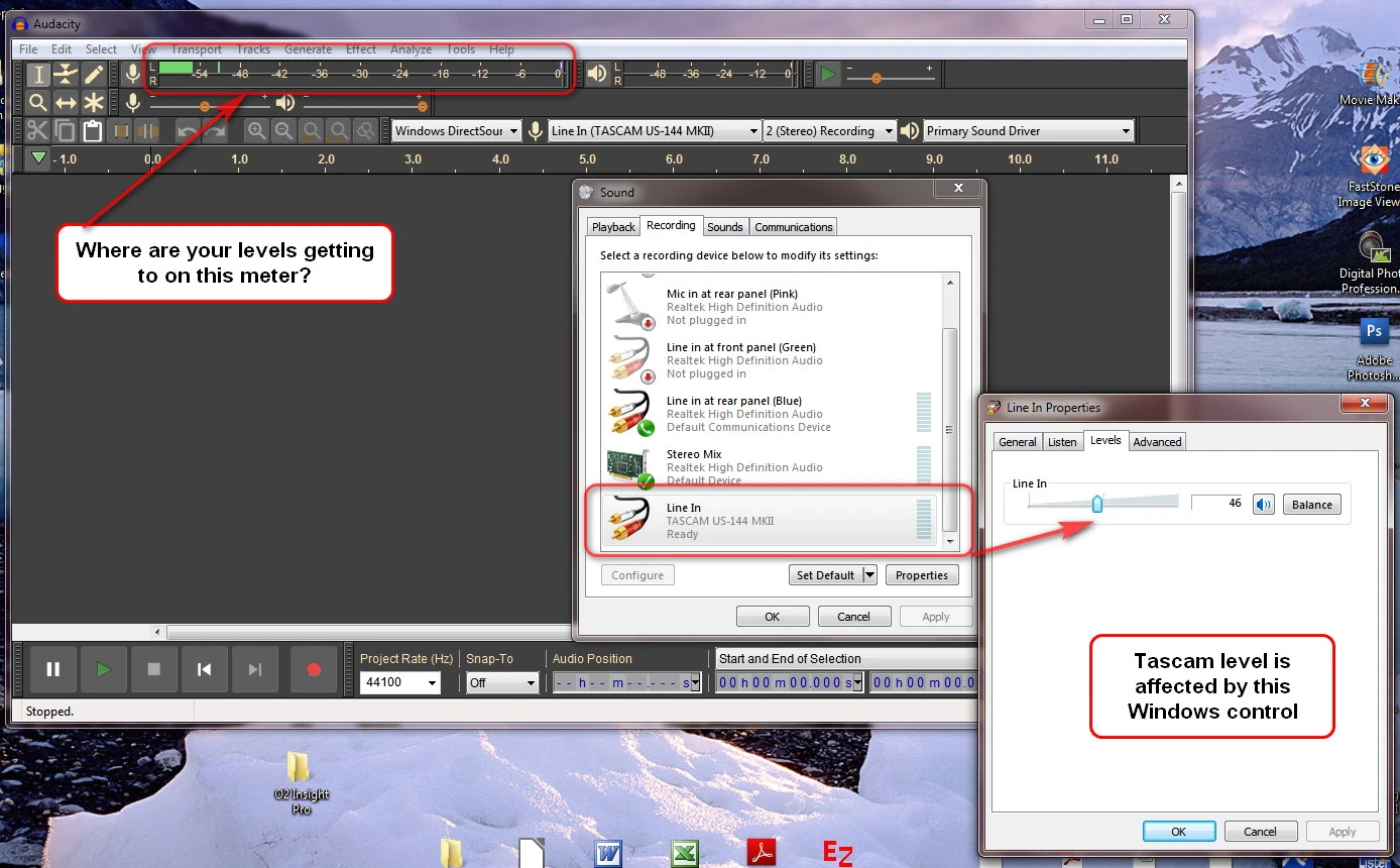

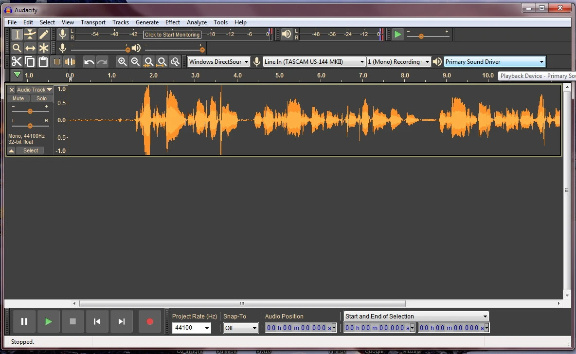

Another screenshot and an mp3 clip. Tascam interface at full gain. Tascam doesn't not use ASIO drivers. Mic was a dynamic with the same sensitivity as your SM86. No processing on the clip
