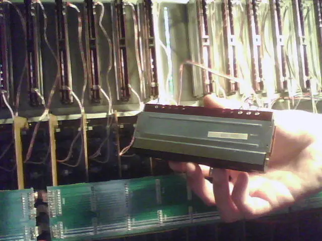

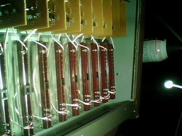

So, I finally opened up my m-312b and it has the faders that Cory's m-500 series/m-308b mixers had (K-series? something else? a picture is attached)... Cory, I know you posted a picture of the fader open, but I was just wondering how those faders actually open up. Can you keep the connections while you open them? My soldering skills are almost non-existent, and I don't want to screw anything up that I can't fix.
Also, everything in the mixer was actually quite clean, and the faders look like they are in great condition - at least from what I can see without opening one up. And while I was in there I found that a fuse is blown (the original manual I got when I bought the mixer is missing the last twenty pages or so I don't exactly know what that would affect), but it is the "2 1/2 Amp 250V" fuse that is at the bottom of the PCB that holds the fuses. If anyone with the manual could let me know what that possibly would affect that would be great... thanks again for all the help.

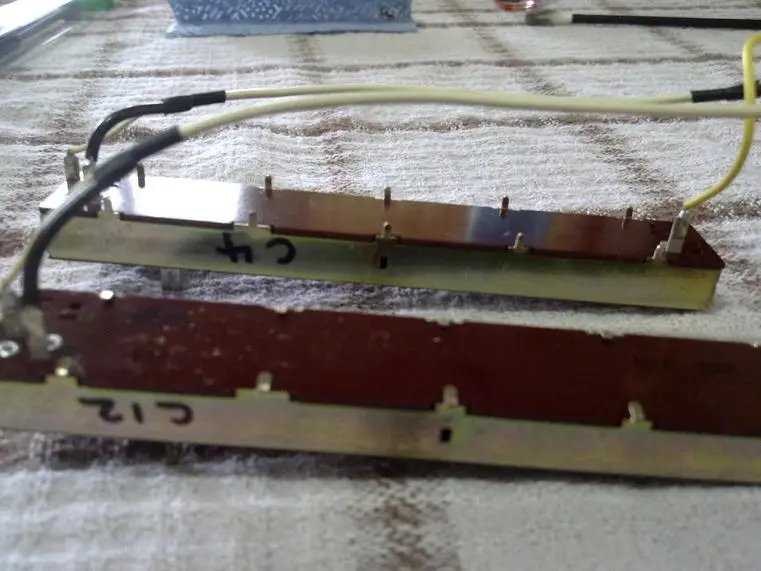

Let me chime in, if I may.... Tonight, with the aid of the great video that Cory made, I was able to, quite painlessly, remove one of the faders. Here's the deal: There are 2 screws holding the faders from the face. Remove them and especially watch out for a little "star" shaped washer under the screw (mine has only one of the washers but there may be two). Don't lose it. The fader then will be hanging by a few wires. Unfortunately they can't be unplugged but are soldered in. No worries tho. As Cory pointed out to me, they will easily sustain the weight of the fader. Now, have you watched Cory's video? The only difference is that you work on opening it up while the fader is still wired to the mixer. Just hold it so that you don't pull anything and try prying open those little tabs and take the element out (as per Cory's video). I'm attaching a few photos how I did mine and what I've found!:eek: Seriously, it may look good from the outside (mine did) but on the inside it's a horror show, crud and grime all over the element and wiper, due to a spill but also from years of accumulated stuff. (Also surely the reason that it doesn't cleanly pass audio). You need to clean it out. So to answer, yes, you can indeed keep the fader element connected by the wires, take off the top (carriage) part and clean the element while it's attached (not to forget the wiper etc..). If you screw up and one of the wires breaks then I'm sure you can just easily reattach it. It should hold tho.
EDIT: I wonder if it could be possible (the way you have your mixer bottom side up) to leave the faders screwed in and actually try to just pry the little tabs off. That way, you will have access to the element and even the carriage (wiper) (can take them out) and leave the rest in place (meaning the metal part of the fader). Might be easier for you but I took mine out 'cause I need to give the metal / rubber casing a bath (yuck).
EDIT2: On second thought, you really should try to remove the faders (as initially laid out) 'cause there's no other effective way to gain access otherwise. You will need to stand the mixer on one of its sides to have access to the top and bottom. I have mine propped on its back (where the connectors are), making sure it sits on a semi-soft area (like a few pieces of cardboard) and that it doesn't fall or sway easily. Then I access the 2 screws on the top and then go on to the bottom to remove the casing and expose the element.
Sorry, I don't think my post/picture made it clear... I attached another picture just to make sure (sorry the resolution isn't the greatest). I have these kind of faders (the upgrade, I believe - not the "low profile" version) and am not exactly sure how to get them apart... I was asking because I saw that Cory had a picture of it intact and then apart - just wondering how he went from point A to point B.

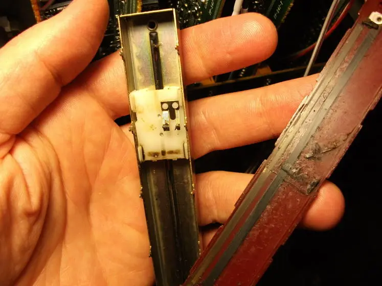

Ignatius, sory for the confusion. I DIDN'T go from point A to point B...the picture of the fader intact and the picture of the fader opened up are different models of faders from two different mixers...I believe they are both ALPS faders but I don't know how your faders open up. I will know at some point because I want to learn and those are the same kind of faders in my Soundtracs desk but I don't know at this point.
Daniel, nice going on getting your fader opened up. ;)
Looks NASTY in there...I'm sure even a basic cleaning would bring that thing back to life.

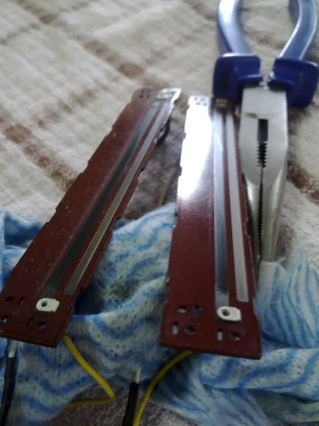

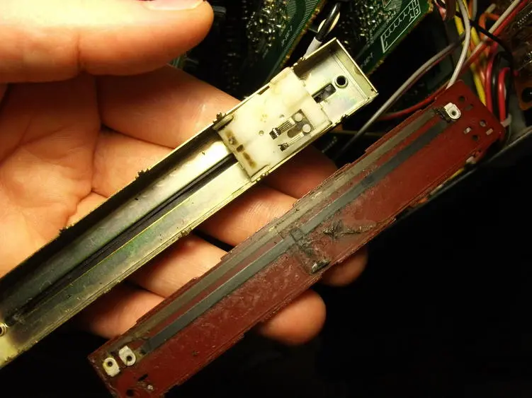

Not sure what was in there but it sure was nasty and some of the stuff was really hardened and tough to get out. Now, some of you will think I'm nuts but I took a microfiber cloth, dampened it in 1:1 ratio of water and white vinegar and poof .. it's like a brand new fader now. :) There is reason behind the insanity you know. :D (Will take photos later).
My plan (slightly deviates from yours - if not already ;) ), is to possibly apply F5, with a q-tip, solely to the tracks. Another thing to do is actually immerse and gently wash the metal part and slider part. Now, as all the grease will be washed away, I thought of applying a tiny amount of white lithium grease, that I have, on the metal to plastic contact / sliding areas. Cory, thoughts, good or bad?

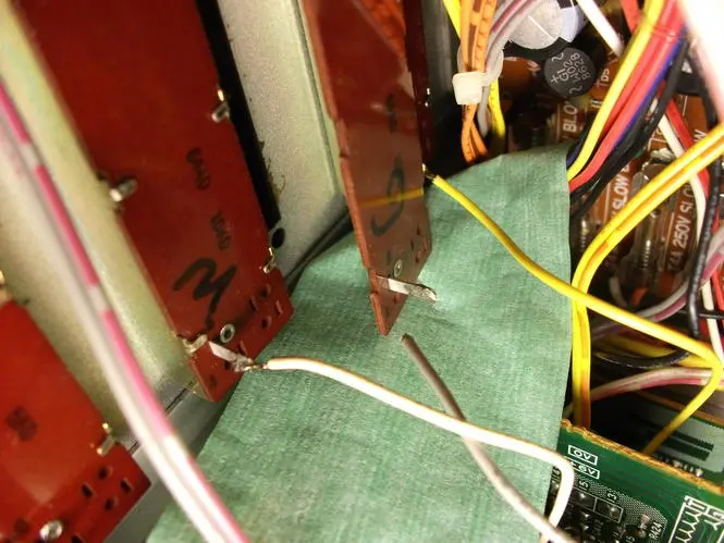

BAD NEWS: One of the short tiny wires unfortunately broke off, from the element. Surprisingly it's way more thin than the others and pretty fragile (all across the faders). Why didn't TEAC design them as plug-in, as in the 388? Shameful.

So are you saying that the wire broke off from the solder lug on the element?
That's a pretty easy repair if that's the case.
It happens.

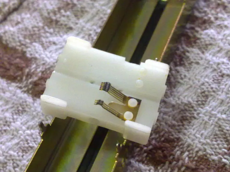

Cory, attached is the photo of that "breakage", to visually illustrate.:(

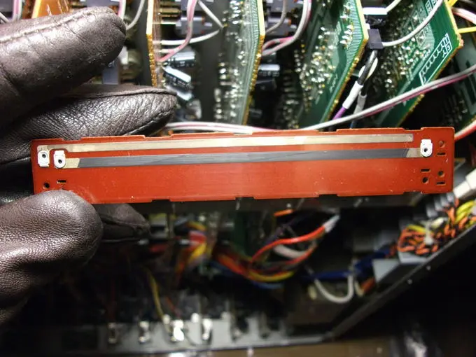

Also attached, ending on a happy note, is that same fader element completely cleaned, using my magical concoction. :D :)

The fader element looks great! :)
Okay, no sweat on that broken wire. Man if you were close I'd jaunt over and fix it up, but you're not soooo...:o
The same things in my soldering tips thread work here too. That lug has a hole in it for the wire and you can heat it up and suck the junk out of it, trim the end of the wire just to get a clean end, strip a little off and solder it back in.
Let me know if I can help but I've had this happen several times so, again, it happens.
Not that it isn't a bummer, but totally fixable.

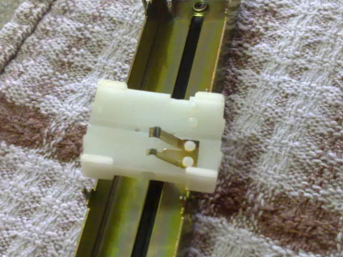

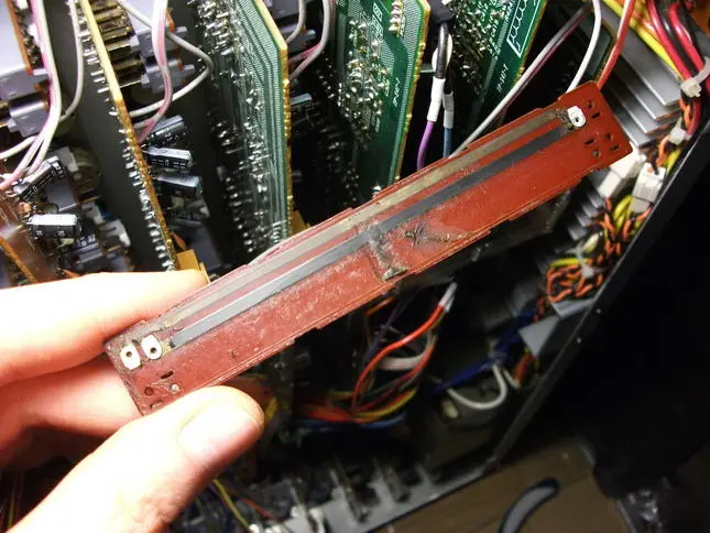

Here's a couple of before and after pics from my cleaning session.

Your threads have been very helpful.
I have been lucky enough to have the plug-in faders in my console.
And have used the deoxit d100 in a nail polish style bottle to clean with. this stuff works wonders.

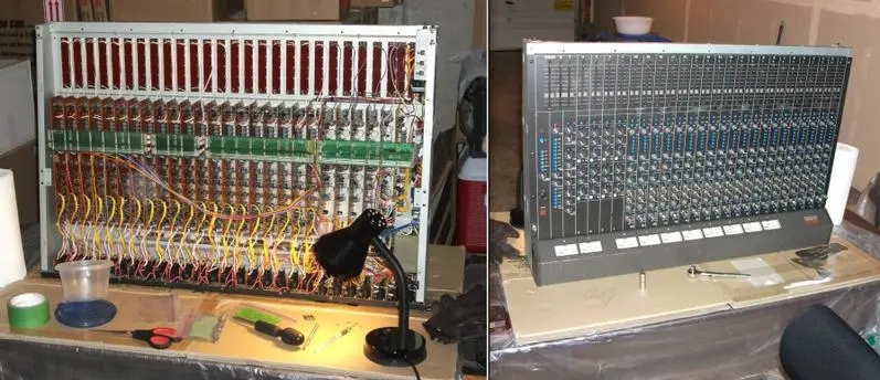

Cory how did you go, getting to the str master and Aux faders in your 520?

I never got to cleaning the auz and stereo master faders on my M-520 but you have to pull the master module and start opening things up to get to all of them...I think the aux master faders are pretty easy as they are along the left edge of the master module...might be the same then for there stereo master faders once you pull the aux master faders but I'm not sure if they are hard-wored or plug in. Leave yourself a trail of bread-crumbs...
