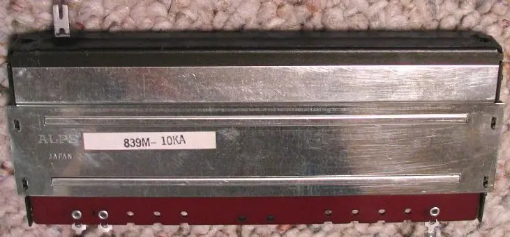

BTW, these are the faders we are talking about...the typical ALPS low profile faders like this:
Yes, immensely helpful, Cory. Many thanks for this especially well made and informative video. It's really a one of a kind "how to...." on cleaning faders. Haven't seen anything like it anywhere. Thanks for the time it took you to do this.
Do you feel that serrated needle-nose pliers are better suited for this or would smooth ones do? I have the latter.

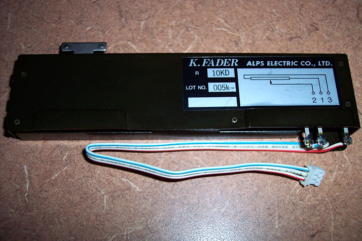

I'll just point out that on some TASCAM mixers (like the 3500 series) the ALPS faders are a different type (ALPS K fader), they are bigger and actually come apart quite easy (no pliers needed).
Also...while I can't speak for the type of ALPS seen in your video, I can say that for the ALPS K faders found in my 3500...the Caig Fader Lube is NOT what you would want to use.
I spoke in depth with TASCAM and Caig about this a few years back, and TASCAM specifically told me not to use any type of lubricant in the ALPS K fader....Caig agreed.
What was recommended by Caig was the D100 (not the D5). Reason was that the D5 has solvent in it, which is needed when you can't get at the area you are cleaning and when the object is very dirty --- the solvent helps flush the gunk away. However, the solvent does leave a residue behind.
But with something like a fader that can come apart, the D100 is pure cleaner and no solvent...so it was the best choice for the faders. You wipe it on to clean, then you wipe it dry so as not to leave any film behind.
Again…the Caig Fader Lube may be just the ticket for some brands/types of faders…but not for all.

So are the K faders like the one pictured below? Those are the type that came in my M-520 as well as my M-308B...I believe they were an option for those mixers. They are also the type that are in my Soundtracs MX. Those are conductive plastic. Its interesting to me that Caig Labs themselves say don't use F5 FaderLube when F5 was designed, in part, for conductive plastic faders...sez right on the can, but I'm not going to argue with the horse's mouths (Caig and Teac). :)
Oh, and assuming what is pictured below is a 'K' type, how do you get them apart? Does that side cover just pop off? I've never tried to get into one but it'll be time before long if I have cleaning to do in any of my Soundtracs faders...

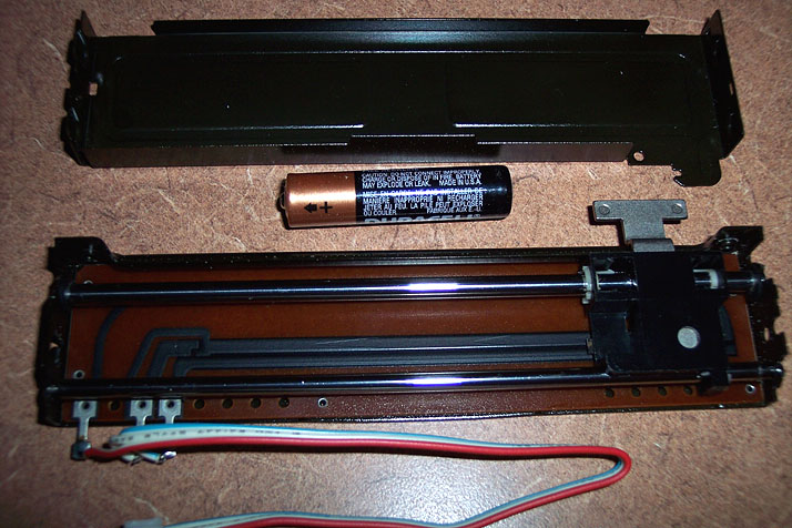

This is the ALPS K-Fader, found in the TASCAM M-3500 console. I included an AAA battery for size comparison, they are 100mm throw faders. As you can see, they just pop open, and snap back together. There are built-in clips on the ends that make it possible.
Don't view the TASCAM/Caig info as contradictory. I'm sure the Caig Fader Lube is the right choice for *some* faders...but not for the ALPS K-Fader...which is dry-as-a-bone even when purchased new (I know). The TASCAM tech I spoke with was clear to point out that any type of lubricant would only gunk up the K-Fader, and Caig agreed, saying that particular fader (and some others) are supposed to be dry, and that their Fader Lube would be the wrong product for it.
So...it's important to find out what YOUR particular fader requires --- a lubricant cleaner or a dry cleaner. If the virgin fader appears 100% dry when first opened, I would not use the lubricant cleaner on them…IMHO. As TASCAM/Caig said...the dry-style faders will appear to be fine at first if you do use the Fader Lube on them, but will only fail/gunk-up that much sooner afterwards. I went their suggestions.
The D100 was the cleaner of choice for the K-Fader, and quite honestly, having used D100 for several years, I think it's possibly the best pure cleaner (no solvent).
If you get the D100, I recommend the small non-spray bottle, and then just apply it with a small brush or Q-Tip (I think some bottles come with a brush).
The pump-spray version doesn't always spray well…sometimes you have to pump it several times to get one burst until it’s primed…and then if you don’t spray again for a few minutes…you have repeat the priming. :(
