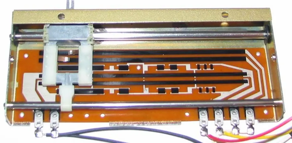

Here is a shot of the board in a fader with conductive plastic...you can see the element tracks are shiny and smooth and homogenous rather than the elements in a carbon-based fader which have a matte finish and you can see a gradation pattern in the elements in those.
OK, I now see the difference and it does look like a night & day difference between our Alps low profile and even miroslav's K-Faders. Thanks Cory! :)
