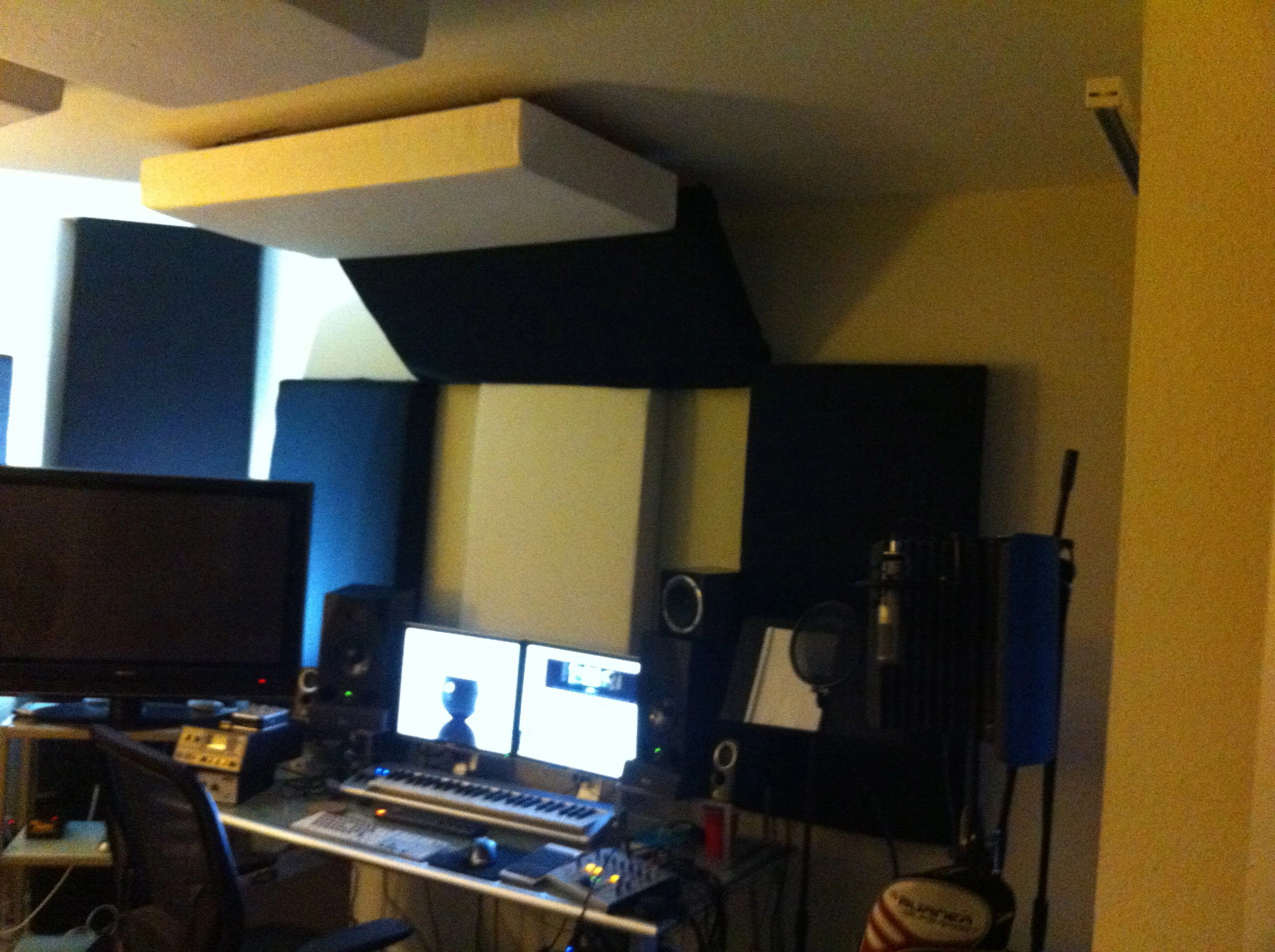

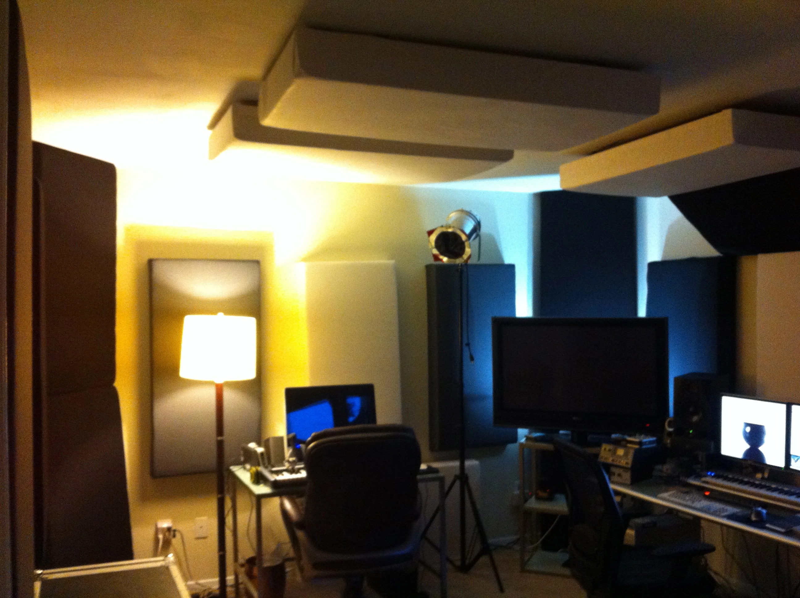

I just did the same thing for 16 panels and I still have big issues in the corners there is probably a better design for real "bass traps" specifically. I used mine as broadband absorbers and traps and although I'm happy with the mid/high absorption the law end 300 and below leaves something to be desired, for now this will do though.

Made 3 frames this afternoon.
Here's some studio pics, followed by the frames I built.
