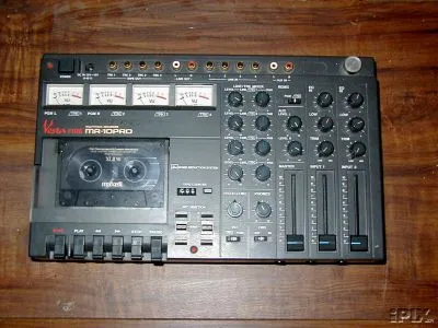

Okay, would the capstan be one of the two prongs which wind the cassette? Because that's the only belt I happened to see after taking the top off.
Also, yes it's a tabletop Portastudio esque machine. I saved an image of one off of eBay, if you wish to see it.
Yeah, pls do.

Anyway, I can't speak directly to the Vestax, sight unseen, but it doesn't sound like you've gotten the capstan belt isolated yet, visually.
You'll definitly need to remove the bottom cover, not the top, or at least I'm pretty sure of that. You'll definitely need to locate the actual flywheel. It's a large cast metal wheel, probably about 2"-2.5" in diameter, and maybe 1" thick, around which you'll see the capstan belt, a flat rubber belt.
The capstan is a single "prong", located in what's otherwise the bottom-right of the cassette compartment. Locate the actual capstan and pinchwheel, and proceed from there.

Also, there really isn't cover to the machine. More like a top and bottom. It's pretty hard to explain some of this stuff... I wish I had a digital camera or something. :)
I attached the image I stole off of eBay to this post...

Justin,
Thanx for posting the image. Your Vesta-Fire is much like a cross between the Tascam PortaOne and the Tascam Porta03. This is a handy little 4-track, that's in need of some minor maintenance. It's definitly an early/mid-80's design, and replacement of the belts is a common and well known issue with decks of this age. If you replace the belts, it will probably run like new.
The tape transport section is of the mechanical variety, which is a little more mechanically complex than the solenoid-driven designs of later years. As you've probably noticed, there's lots of little levers, cams and springs in there, which makes repair a bit of a complex task, but still doable if you're careful. I believe, in most cases, the capstan belt would be accessible by removing the bottom cover, and accessing the mechanics through the bottom.
You'll have to identify the capstan and the capstan flywheel, and proceed from there. Moderate disassemby will be required. Good luck.
