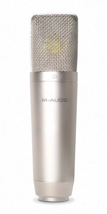

I have an M-Audio Nova mic, which has a polar cardioid pattern. I know what a polar cardioid pattern is (I think) but I don't know how it fits on this microphone. I can picture the pattern on something like a Shure 58, but the Nova has two sides, not a front. Are both sides included equally? Are you supposed to sing/record at the front instead of the sides? And one of the advantages of a cardioid mic is rejection of noise in the other direction. What other direction? How do I point it away from an unwanted sound source?

Just sing into the said that has the M-Audio/Nova names and the cardioid pattern facing you.
That's the front of the mic.

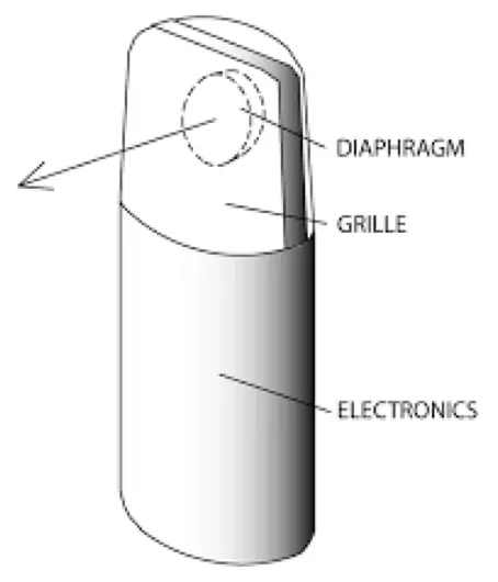

Yes, that is a "side address" microphone. NB there are a few mics that LOOK like they are SA but are in fact "end fire" like a 57!
Keep in mind as well that the cardioid pattern is "solid" you need to mentally rotate the plan view. Not perfect of course since the mic body gets in the way. Note too that mic patterns have little projections? They are not the nice, clean diagrams you see! These "spikes" of sensitivity come out at about 60dgrs either side of the rear null so if you seem to be picking up an odd noise sometime, try rotating the mic 30dgrs or so. Lastly you don't HAVE to yodel dead on axis! Popping and sibilance are often cured by going across the diaphragm more than "at it".

This is the front:-
The front of the cardioid pattern points here:-

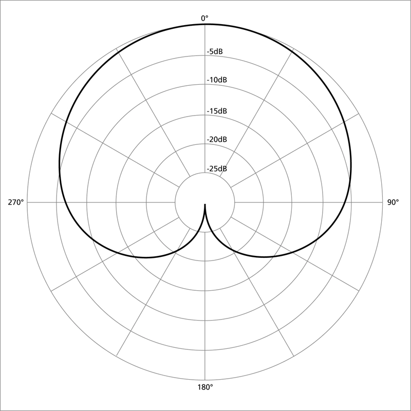

This is what a cardioid pattern looks like:-

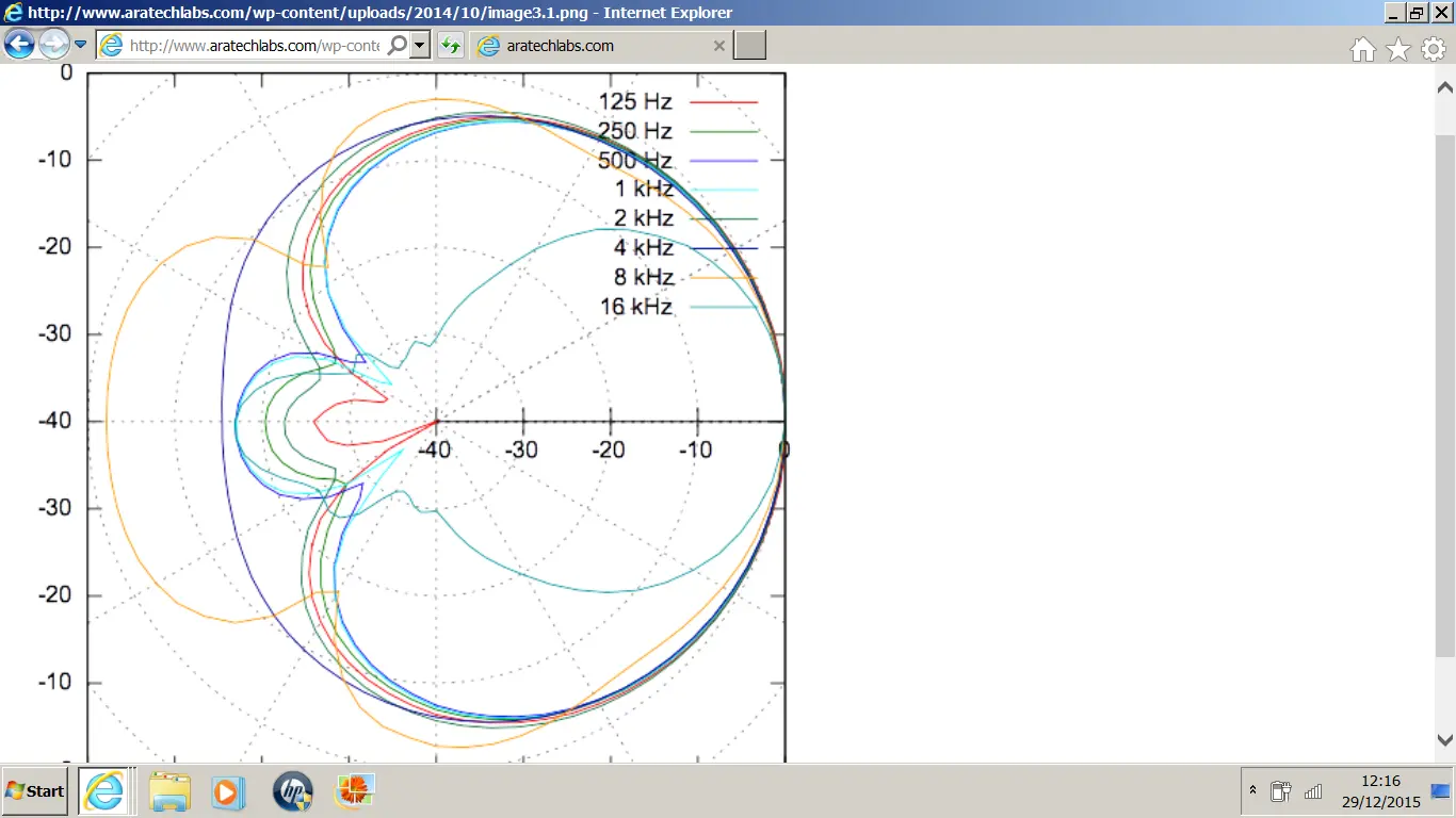

Attached is what I am talking about. You can see the sticky out bits at various frequencies. I might suggest that the "attitude" differences of microphones and the complex way that they interact with rooms is down in great part to these "wandering lobes"?
This is a wierd polar-patten.
Wide-cardioid at 500Hz - strange and non-symmetrical at 125Hz - cardioid, bordering on super-cardioid at other frequencies - then getting real hyper-cardioid at 8kHz and almost lile a gun mic. at 16kHz.
Be very careful with the rear as you will have out-of-phase anomolies picked up here, especially at 8kHz.

Actually, according to the polar-pattern you posted, maximum sound rejection is at about 120˚ rather than at the rear.
Yes John, weird indeed! But I struggled to find a pattern that was not a smooth, idealized curve! Like frequency response curves (for transducers) Beelzebub is in the detail.
