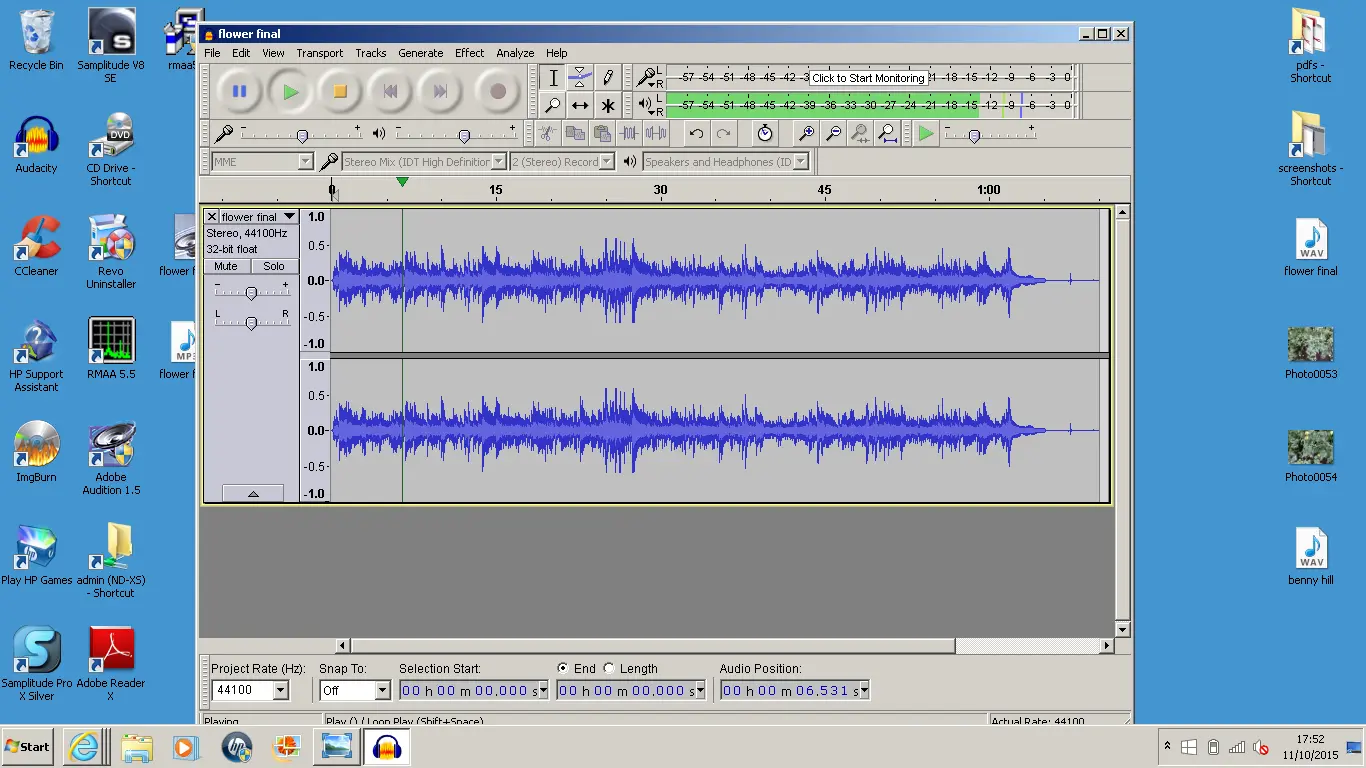

See the meters top right?
Yours should be running about the same level (mine are actually a little hot) . It is quite likely that the gains controls on the Tascam will be close to, even at max with dynamic mics and certain sources. Speech for instance will need all the gain and a pretty close, like an inch, mic position.
